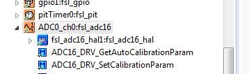

In the KSDK 1.2, I initialize and calibrate an ADC channel by drivers I found in the component list:
  ADC16_DRV_Init (0, &ADC0_CalConvConfig); //set ADC to s/w trigger mode for calibration
  ADC16_DRV_GetAutoCalibrationParam(0, &ADC0_CalConfig); //calibrate ADC0
  ADC16_DRV_SetCalibrationParam(0, &ADC0_CalConfig);
  … but there is no mention of this function in the API Reference Manual. I have been told this function actually calibrates the ADCs. Is it really this easy? I can’t determine certainly from setting breakpoints if any of the offset, gain or calibration register values actually changed from those that are already in them (from previously issuing this command). Is there any documentation on these driver calls and parameter structure?

You are right, this function is not documented in the API Reference Manual but you can see the description about this function in the file fsl_adc16_driver.c. The function description is:
/*Function Name : ADC16_DRV_SetCalibrationParam
* Description  : Set the calibration parameters for ADC module. These
* parameters can be fetched by launching the process of auto calibration
* or to use some predefined values that filled in the structure of
* "adc16_calibration_param_t". For higher precision,  it is recommended to
* execute the process of calibration before initializing the ADC module.
* Since this API may be called before the initialization, it enables the ADC
* clock internally.
Also, you need to call the function ADC16_DRV_GetAutoCalibrationParam before ADC16_DRV_SetCalibrationParam. Its description is above.
/* Function Name : ADC16_DRV_GetAutoCalibrationParam
* Description   : Execute the the process of auto calibration and fetch
* the calibration parameters that would be kept in "adc16_calibration_param_t"
* type variable. When executing the process of auto calibration, the ADC
* has been configured internally to work in the situation with highest
* precision. Since this API may be called before the initialization, it enables
* the ADC clock internally.
You can calibrate your ADC just by calling the below code snippet.
#define ADC_INSTANCE     (0)
adc16_calibration_param_t userCalConfig;
ADC16_DRV_GetAutoCalibrationParam(ADC_INSTANCE, &userCalConfig);
ADC16_DRV_SetCalibrationParam(ADC_INSTANCE, &userCalConfig);
