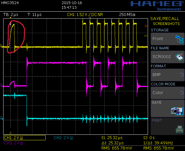

I setup/configured an SPI interface at driver level (DRV calls - speaking about KSDK): SPI clock, MISO, MOSI and Slave Select pins, bit rate 1MHz, polarity active high, phase on first edge, Msb first.
After two days struggling for make it work, I managed to find the problem.
Right at the beginning, after the first negative results, checking the SPI signals with an oscilloscope, revealed a glitch just before the SPI clock start (see Image_1.bmp).
Yellow track: SPI clock
Violet track: MISO
Blue track: SPI slave select
But I didn't care that much since the SPI select goes active (low) at the beginning of the SPI clock period.
The CLRC663 responded bad things in this situation, so after pin checking and other stuff, I decided not to use the hardware SPI slave select, but using the same pin as a GPIO, and controlling it manually in my SPI routines.

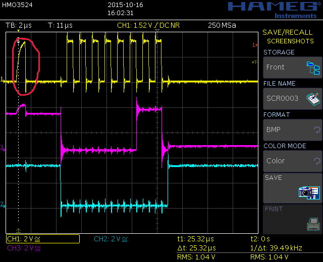

So I went in this other situation (see Image_2.bmp).
As you can see the glitch is located in the same position, but this time slave select goes low far before the SPI clock starting.
In fact my code is doing like this:
GPIO_DRV_ClearPinOutput(SPI_EN_663);
retval = SPI_DRV_MasterTransferBlocking(FSL_SPICOM1, NULL, buffer_ptr, &spi_rx_buf[0], length, SPI_TIMEOUT);
As you can guess also in this case SPI data is not correct because glitch occurs when the slave select is already active (low).
So, who's doing that glitch???

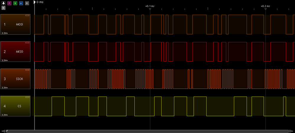

By going step by step I discovered (thanks also to my colleague Stefano) that is due to the lines into the file 'fsl_spi_master_driver.c':
SPI_HAL_Disable(base);
SPI_HAL_Enable(base);
For preventing this glitch I commented the first line ( SPI_HAL_Disable(base) ), but since the important comment just above in the code:
/* In order to flush any remaining data in the shift register, disable then enable the SPI */

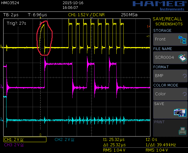

I added the two lines above in my SPI routines:
In this way the glitch appears but before the slave select goes low, and the CLRC663 has all the time to know I'm going to communicate with SPI.
The results are here in Image_3.bmp:
In this way using GPIO I can easily select which SPI peripheral to use for communication (if I have more than one on the same bus), and can also cope with devices not so fast recognizing SPI clock, when enabled it its proximity.
But all of this has been achieved in a quite "dirty way", by modifying the SDK code at driver level (see line commented).

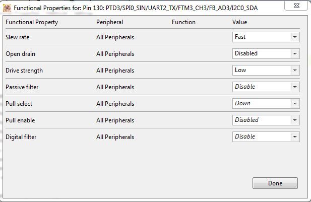

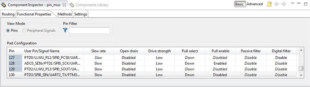

I have been trying to get something on the MISO line, however I am unable to see anything.
While in parallel I have got the LDD working on the same board with almost same SPI register settings working properly as expected.
I was having a thread here on that issue here
SPI driver read not functioning with KSDK 1.2.0
also, I was wondering if there is any way to put LDD on my project, because the issue doesnt seem to exist with it and is only seen with the driver coming along with KSDK 1.2.0.

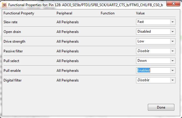

I have done pin settings for SCLK with pull down and other ping settings as shown here

Kewal
Hi David,
I am having a similar problem where MISO is not able to communicate.
the below screen shot is the communication established through the LDD
While I am trying to use the PDD now along with safeRTOS and I believe i have done the right pin settings as well but still unable to see any response from the slave chip.
What could have gone wrong also my pin settings looks like this
Is there anything like busconfiguration init required before starting the communication.
thanks,
Kewal
