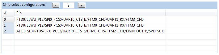

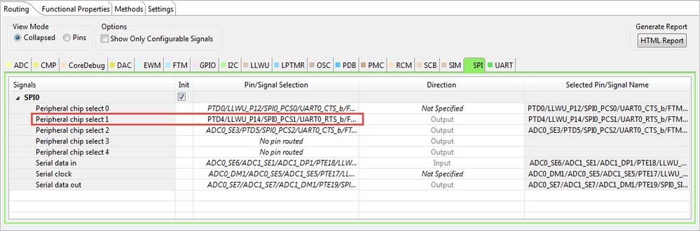

If you want to use PEx to configure this pin as SPI0_PCS1, just configure Chip select pins as follows:
And then, in pin_mux component, select PTD4 pin for chip select 1:
And everything will be configured correctly.
I hope this helps!

This is exact my current setup. My only question I have is
In PE, fsl_dspi component, since "Chip select configuration" #0 and #1 are the same pin. Does this setup conflict with pin-mux selection ? if not, why we need do "chip select configuration"?  Can we just uncheck this box ?
Haojian

Hello HJ,
Indeed, this chip selection configuration table is used to select which pins will act as PCS and it populates the pin-mux section, however, as PTD4 cannot be selected due PEx's known issue, you cannot use the pin_mux section to do this. So you can uncheck this box.
Only be sure that hardware init does contain pin initialization for SPI pins.

haojianxu
Hi Isaac,
Here are my understandings based on your comments:
1. component fsl_dspi, uncheck "Chip select pin" section.
2. component pin_mux:PinSettings, I selected Pin-41,Pin-45,Pin-46 as "Chip select 0,1,2".
In fact, I checked "pin_mux.c" file. It looks like whatever fsl_dspi configurations are, pin_mux.c will following "component pin_mux:PinSettings" not fsl_dspi.
Let me know if I misunderstanding anything.
HJ

isaacavila
Hello HJ,
Yes, you are right, as long as every pin is configured correclty and SPI master has different configuration to use each PCS signal, you will be able to manage transaction for every PCS pin (PCS0, PCS1, PCS2).
I hope this helps!
