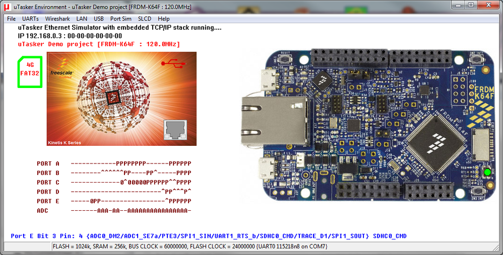

A big advantage is also that the FRDM-K64F, the SD card and Ethernet can be simulated in (approx) real-time using VisualStudio so the SD card operation can comfortably be tested without needing HW. This makes code anysis very efficient as well as general project work much faster than traditional techniques. Below is a screen shot of the attached binary project running in the simulator
