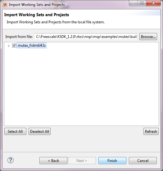

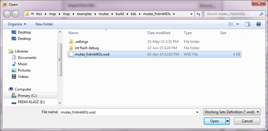

Please, what example are you trying to flash?
Have you tried to import the project as .wsd file?
Please, delete the project from the workspace and Import example in KDS
after that please try to debug firstly all libraries and at the final the project.
