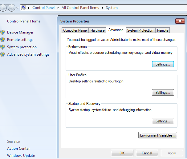

Hi Anders,
In kds, use SDK need fix environment variable fellow below :
And whether nee do like this in your platform ?
Hope it helps
Alice

andersbergström
I tried to change the PATH and now it seems to work with a custom folder.
However, im not sure that it was the cause of the problem since I changed back the KSDK_PATH variable, and now it is working with a custom folder for the KSDK.
