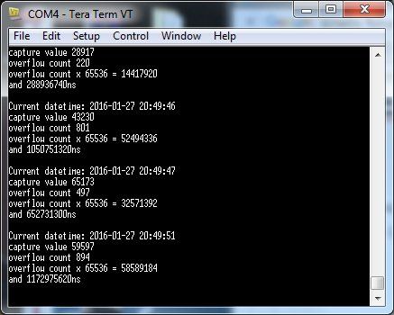

I have the RTC set up to give an interrupt every second, in the interrupt I reset the FTM counter and my software FTM overflow counter and then wait for an input capture. When I get the input capture I print (over USB-CDC) the time in hours, minutes, seconds and then the time to the input capture event in nano-seconds. The FTM is set up to be clocked at 50MHz so the tick is 20nS.
Thus the highest value I would expect to see in my "software" overflow counter before the "seconds" interrupt cleared it, would be 1/(65334 x 20nS) = 762
However I regularly see values over this, can anyone say why this would happen?

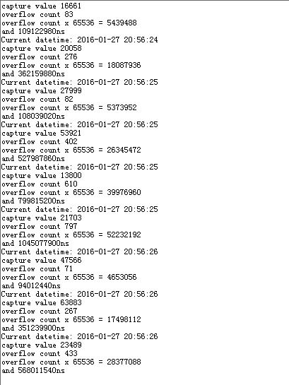

.....and here is the terminal view, with a couple of examples (second and last) with the overflow count significantly above 762, any thoughts?

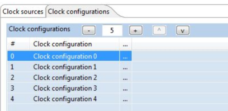

Hello Ernest,
Please pay attention that , there are five clock configuration you can choose:
if you want use the mode 0, please configure it at here :
pastedImage_1.png,
then in the FTM component , the clock source you can choose 50MHZ.
In your project , for you chose the mode 4:
we can see in the mode 4, the system clock is 60MHZ, so ....

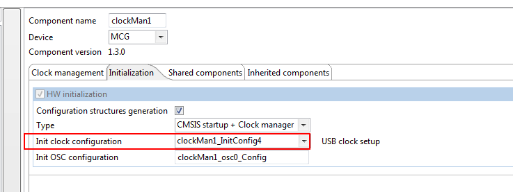

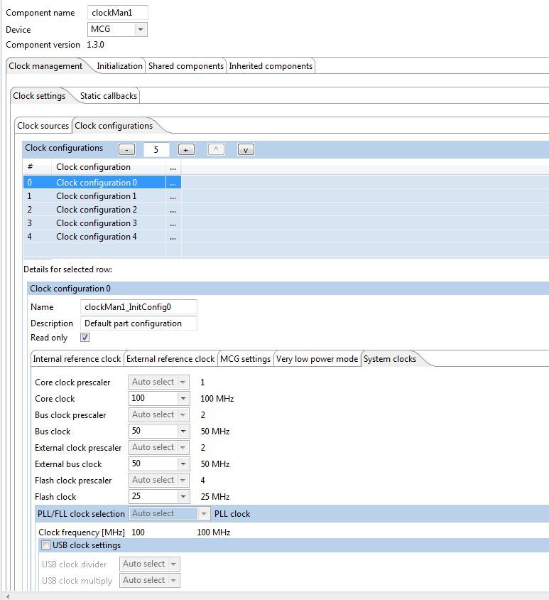

Hi Alice, thanks for the insight, that would make sense, but please have a look at my MCG settings, they are set to have the system clock at 50MHz, but for some reason the FTM is saying that the system clock is 60MHz.
Is the FTM overwriting the settings from the clockMAN? Also, I can not seem to be able to change the FTM component inspector to 50MHz.

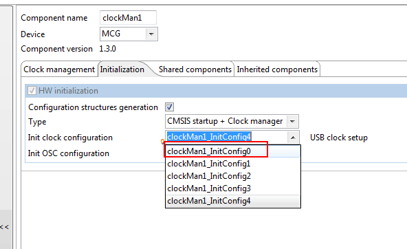

Hello Ernest,
pastedImage_1.png,

Ahh, I had missed that, thank you very much for your help. I tried to change clockman_initconfig 4 to have a bus clock of 50MHz and a USB clock of 48MHz but this seemed not to be possible, is this correct?
I would prefer to operate at 50MHz bus rather than 60MHz bus as this makes the maths much faster as I can use a shift rather than a multiply.

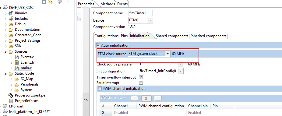

Hello Ernest,
I have checked your code and test it , from the PE configuration , we can see you configure the
clock source of FTM0 60MHZ,
so  we should change  this 1/(65334 x 20nS) = 762  to  60MHZ/65334 = 918 .
And from your result , this is no "overflow count" more than 918 , and also in my test , there is neither .
Hope it helps
