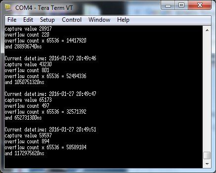

I have the RTC set up to give an interrupt every second, in the interrupt I reset the FTM counter and my software FTM overflow counter and then wait for an input capture. When I get the input capture I print (over USB-CDC) the time in hours, minutes, seconds and then the time to the input capture event in nano-seconds. The FTM is set up to be clocked at 50MHz so the tick is 20nS.
Thus the highest value I would expect to see in my "software" overflow counter before the "seconds" interrupt cleared it, would be 1/(65334 x 20nS) = 762
However I regularly see values over this, can anyone say why this would happen?

.....and here is the terminal view, with a couple of examples (second and last) with the overflow count significantly above 762, any thoughts?

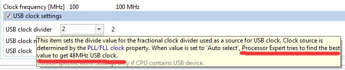

Ahh, I had missed that, thank you very much for your help. I tried to change clockman_initconfig 4 to have a bus clock of 50MHz and a USB clock of 48MHz but this seemed not to be possible, is this correct?
I would prefer to operate at 50MHz bus rather than 60MHz bus as this makes the maths much faster as I can use a shift rather than a multiply.

Hello Jim,
Yes, if you configure the bus clock to 50M, the best value to 48M of USB is configure to 50M.
Hope it helps
Alice Yang
4,854件の閲覧回数
therealfreegeek
Hi Alice, yes that is what I tried, however the closest frequency that could be generated for the USB was 50MHz with a 50MHz bus which caused an error.
For the time being it is not too big a problem for me to stay with 60MHz bus frequency which does allow a 48MHz clock for the USB.

Hello Ernest,
I have checked your code and test it , from the PE configuration , we can see you configure the
clock source of FTM0 60MHZ,
so  we should change  this 1/(65334 x 20nS) = 762  to  60MHZ/65334 = 918 .
And from your result , this is no "overflow count" more than 918 , and also in my test , there is neither .
Hope it helps
