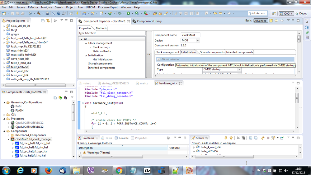

I noticed that Processor Expert doesn't generate a call to Clock System Initialization function inside "hardware_init" function. So, my question is, where is this called? Or it is not called anywhere and I must drag and drop into my code (what wouldn't make any sense to me, since it should be a Processor Expert role)?
When I place the mouse over "HW Initialization", KDS tells me the initialization of clock system is automatic and is performed via CMSIS startup, but where is this startup file, where is the call for a Clock Initialization function?
"hardware_init" and "PEX_components_init" functions are in grey, although "CPU_HARDWARE_INIT" and "PEX_COMPONENTS_INIT" macros are enabled:

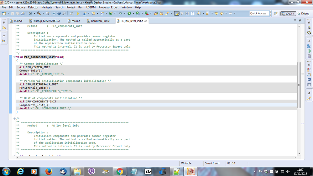

The same ocurrs for "Components_Init" function, which doesn't have anything inside it:
#if CPU_COMPONENTS_INIT
void Components_Init(void)
As you can see bellow, "hardware_init" function doesn't call any Clock System Initialization function, what should be the expected.
void hardware_init(void) {
  /* Enable clock for PORTs */
  SIM_HAL_EnableClock(SIM,kSimClockGatePortA);
  /* Setup board clock source. */
  g_xtal0ClkFreq = 8000000U;            /* Value of the external crystal or oscillator clock frequency of the system oscillator (OSC) in Hz */
  g_xtalRtcClkFreq = 32768U;            /* Value of the external 32k crystal or oscillator clock frequency of the RTC in Hz */
  init_jtag_pins(JTAG_IDX);
  init_osc_pins(OSC_IDX);
  init_tpiu_pins(TPIU_IDX);
My Project is using bare metal, KDS and KSDK 1.3.0. And the MCU is MK22FN256.
I tested with a new project with MK22FX512, and the functions, this time, are not in grey, unlike with MK222FN256. But I also can't see any reference to a Clock Initialization function. Should it be a Processor Expert bug?

Hello Marco Aurelio:

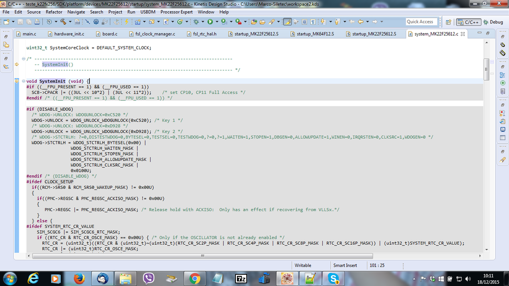

Clock initialization is made in the function SystemInit() from the file system_<device>.c. This function uses the macro definitions from the header file system_<device>.h.
System clock is initialized before reaching main. The initial configuration used is the one you select from the fsl_clock_manager component. See below an example:
In this case there are 6 clock configurations and the configuration 1 is used for the CMSIS startup code.

SystemInit function is all in grey. What should I do?
Have attached my code.

Hello, Jorge
Yes! You hit the bull's eye!
After following Erich's tutorial, the grayed out areas became white. But, as you said, that is not an issue, since the code is executed in a debug session, even when it is in gray. What really matters is if the macro above the code is enabled or not.
