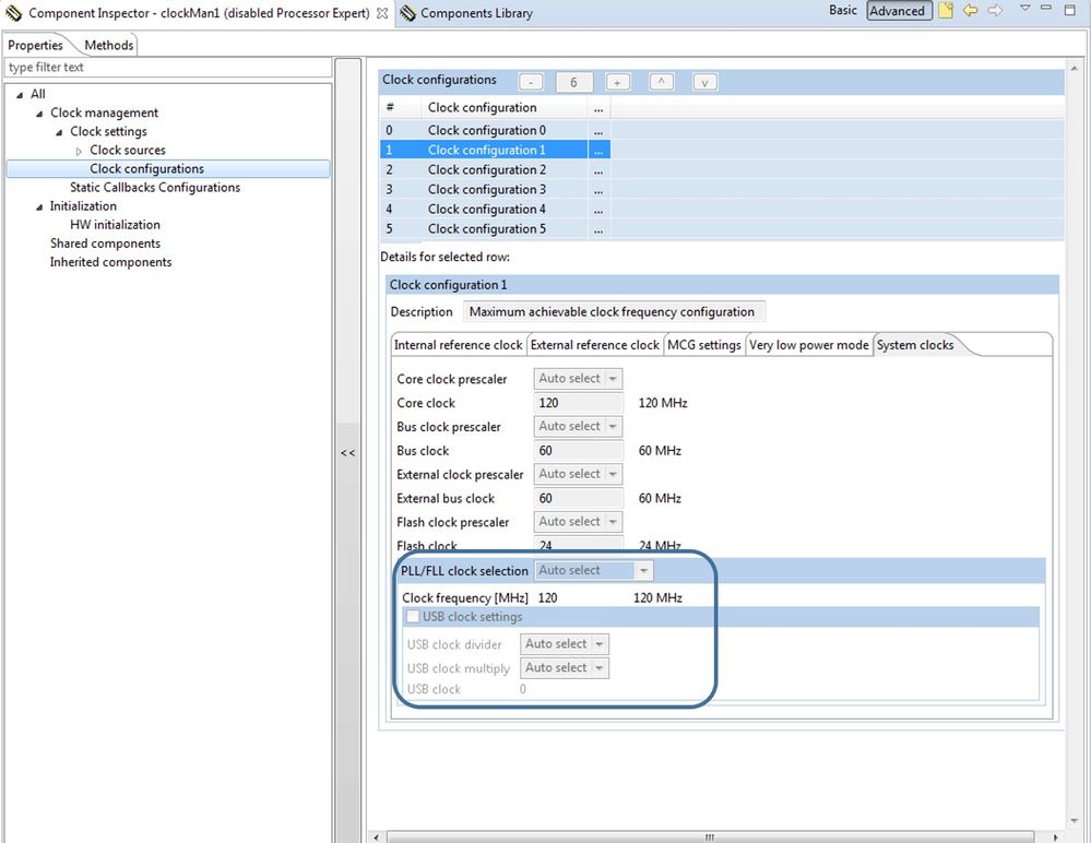

I can't get Real Time Clock and USB CDC to work together.
I am using KDS 3.0, KSDK 1.2 on a FRDM_K22.
I am able to run the USB CDC demo: C:\Freescale\KSDK_1.2.0\examples\frdmk22f\demo_apps\usb\device\cdc\virtual_com\freertos\kds
and the RTC demo: C:\Freescale\KSDK_1.2.0\examples\frdmk22f\demo_apps\rtc_func\kds
separately but I have trouble combining them in a new project.
RTC works but CDC doesn't. I don't get a USB_DEV_EVENT_CONFIG_CHANGED event.
I zipped the project. There is a conditional compile ADDRTC. if undefined CDC works.
I think the problem is in BOARD_ClockInit() which is called for the RTC setup.

Hi Joe,
In fact, it is related to Clock settings on your configuration.
In K22, you can use either PLL, FLL or IRC48MHz clock to feed USB module. As you may know, USB needs a 48MHz input frequency in order to work correctly.
In your case, when you don't add RTC support, clock configuration is set to produce a 48MHz output from PLL, this frequency feeds USB module (that sets divisor to 0) and CDC functionality works as expected. However, when you add RTC support and change clock configuration, PLL output is now 120MHz and it is passed as is to USB module (with USB divisors set to 0) so that is why USB does not work.
You can implement different solutions, one is, obviously, set PLL output to 48MHz (using clock configuration used when no RTC is added). Another is, to set USB clock reference to IRC48MHz instead PLL. I implemented the second one:

The best solution (using PE) will be to set USB clock settings in fsl_clock_manager component for the clock configuration 1 (the one that sets PLL to 120MHz)
Again, I used the second solution and test it. Now CDC device is enumerating and working correctly when ADDRTC is defined.

Thank you for the detailed response. The fix works/!
