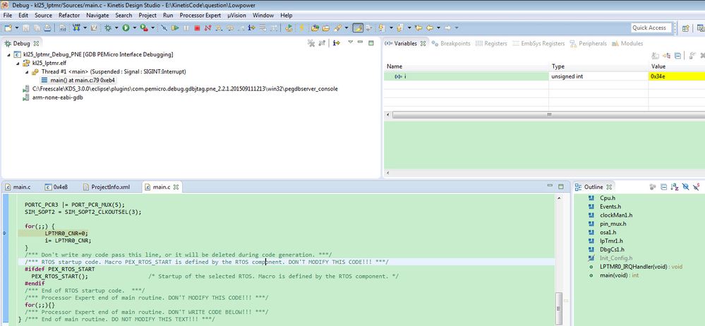

i have a problem using the sdk 1.3 and the lptmr. I set this for count 10sec  (i will use this to wake up the micro) but this not count. I have attach the project, i don't understand.... i have check the clock source (LPO) and i think is set correctly. Thanks

Hi Daniele Cortellazzi,
        Thank you for your interest in Freescale kinetis product, I would like to provide service for you!
         Did you check it in the debug mode?
         If you want to read the LPTMR0_CNR, you need to write a arbitrary value to this register, then you can get the CNR value correct. But it won't influence the function of the LPTRM.
        I create a KDS KSDK LPTMR project based on KL25, it can realize the 1s LPTMR count, and when it reaches 1s, toggle PTB18, I already test it, please refer to my code.
       When want to read CNR, you do it like this:
       unsigned int i;
       LPTMR0_CNR=0;
       i= LPTMR0_CNR;
Then you will get the CNR value, and you can find it is really counting.
I hope it can help you!
If you still have quesiton, please contact me!
Jingjing

danielecortella
Contributor V
Many thanks for the reply.
Now it's work. I want to use the LPTMR to wake up the system from VLLS1. Now my problem is how handle the wake-up of the system, i need to reset the device when the system power on. With the old pex there was the function Cpu_SystemReset(), with the sdk 1.3 how can i do?
