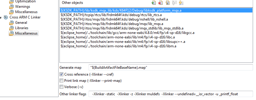

I tried adding -u _printf_float to my linker settings for my application, but it didn't work:
Can you please tell me if I've missed something?  Thanks!

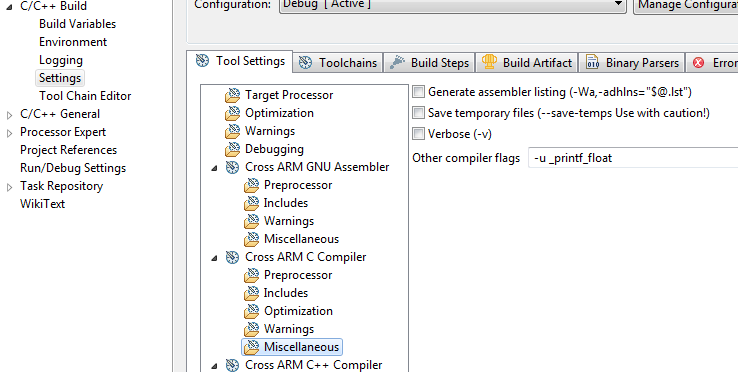

I went to Properties->C/C++ Build->Settings->Cross ARM C Compiler->Miscellaneous then in the "Other compiler flags" box I added "-u_printf_float".  That seemed to work for me.  Are you using KDS, KSDK, and PEx with the FRDM-K64F?
Michael

dave408
Senior Contributor II
This is so odd.  Setting the compiler flags didn't work for me, either.  I'm using KDS 2.0, KSDK 1.1, and MQX.  I am not using processor expert.  This is with a K64F.  I just found a post by Erich Styger, so I'll check that out now.  Thank you for your prompt reply!

Okay, I haven't tried this with MQX yet so that might be the difference. Screenshot below for help.
If you find the answer please post here.

matthias
Hello Dave,
I had a similar problem, so maybe this solution helps: printf() with float values
Matthias

dave408
Hi Matthias, thank you *so* much for posting a link to your thread!  That was absolutely the problem, and now printf is able to display fp values.  Thanks!!!
