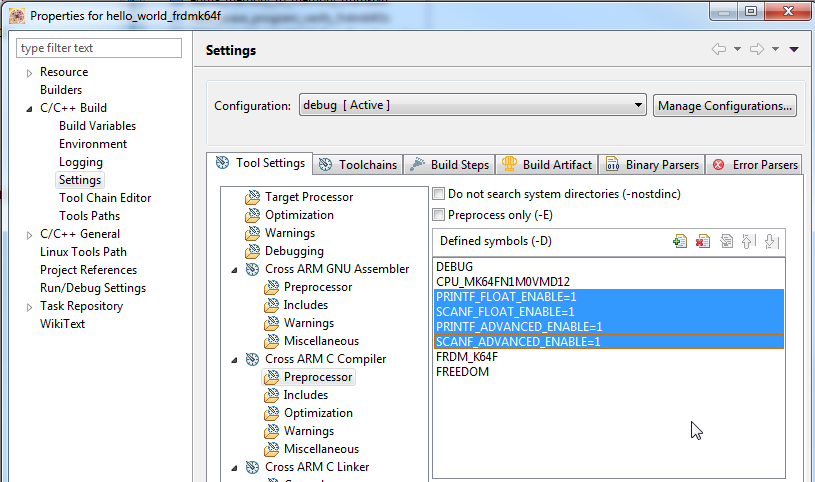

DavidS
Hi Stephen,
I'm using a FRDM-K64F with KSDK_v2.  I cloned the hello_world example and placed it in my path as follows:
C:\NXP\KSDK_v2\SDK_2.0_FRDM-K64F_KDS\boards\frdmk64f\user_apps\hello_world_fp
I think you just need to enable the #defines in the Properties->C/C++ Build->Settings->Tools Settings-> Cross ARM C Compiler->Preprocessor
All of the PRINTF/SCANF were=0.  I changed to =1.
David
PS
I tested on FRDM-K22F successfully too using the standard hello_word example in KSDK_v2.
