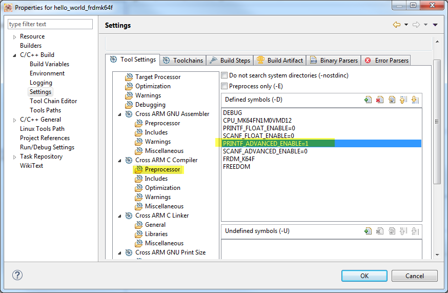

Hello Robert,
to print negative number, please:
1.enable PRINTF_ADVANCED_ENABLE=1 in preprocessor setting.
2. remove bracket from %d
PRINTF("int32 = 0x%x %d\n", int32, int32);
see attached video.

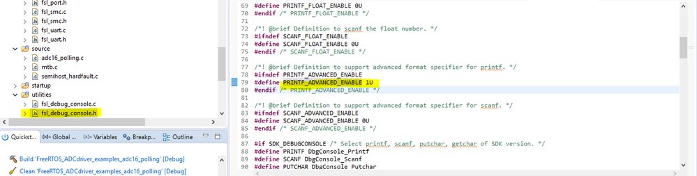

danielcolon
I had this same problem using KL25Z but rather than modify the Preprocessor option like in the picture above, I found out the same definition within fsl_debug_console.h. Before it was defines as "#define PRINTF_ADVANCED_ENABLE 0U", I just change the 0 by 1 and the negative numbers started to appear =).
However I still have a doubt for the SDK staff... Which ones are all of those ADVANCED features that got enabled with this define?

ZhangJennie
Hello Robert,
see attached video.
Jennie Zhang

ZhangJennie
thanks for your feedback.
I just checked the screenshot, the correct setting is PRINTF_ADVANCED_ENABLE=1.
I just modified the screenshot to the correct one.
the video use setting of PRINTF_ADVANCED_ENABLE=1. it's right.
Thanks.
