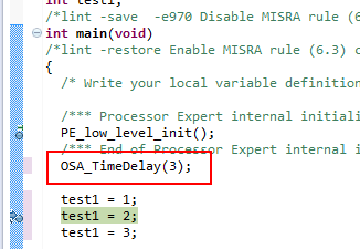

Calling OSA_TimeDelay on the TWR-K64F120M is hanging my application.  If I step through with the debugger it gets into OSA_TimeGetMsec and never returns.  Is there something special that needs to be initialized for these functions to work, or is this possibly a bug in the board specific files for this demo board?

Hi Kevin,
Try following please and let us know what happens.
#if 1 /* //DES 1=test, 0=default code */
  CLOCK_SYS_EnableLptimerClock(NULL); /* //DES enable clock to LPTMR0 module */
  LPTMR_HAL_SetFreeRunningCmd(LPTMR0, 1); /* //DES set LPTMR0 to free running */
  LPTMR_HAL_SetPrescalerClockSourceMode(LPTMR0, kPortLPOClock); /* //DES set LPTMR0 clock source to LPO */
  LPTMR_HAL_Enable(LPTMR0_BASE); /* //DES enable LPTMR0 module */
#endif
  RTC_DRV_SetDatetime(FSL_RTCTIMER1, &datetime_des);
  /* For example: for(;;) { } */
  while(1) {
  OSA_TimeDelay(1000/2); /* //DES test function that uses the lptmr. */
  PORT_HAL_SetHighGlobalPinCtrl(PORTB_BASE,21, 0x100);
  counter++;
  counter++;
  counter++;
  counter++;
  if(!(counter % 0x10000)) {
  RTC_DRV_GetDatetime(FSL_RTCTIMER1, &datetime_now);

Hi Kevin,
Which version of KSDK do you use ?
And there is nothing to be initialized , it can directly use , like this :
If you still can not use it ,you can send your project to me or tell me how to recurrence your appearance.
Alice
3,079 Views
kalden_srcinc
KSDK 1.1.0.
I'll strip my project down into a simple example case and post it here.  Just to clarify though, the function takes milliseconds, correct?

kalden_srcinc
I just needed to add #include "fsl_clock_manager.h".
Yes this seems to have fixed the problem.  Is this code that should have been included in hardware_init  ?
