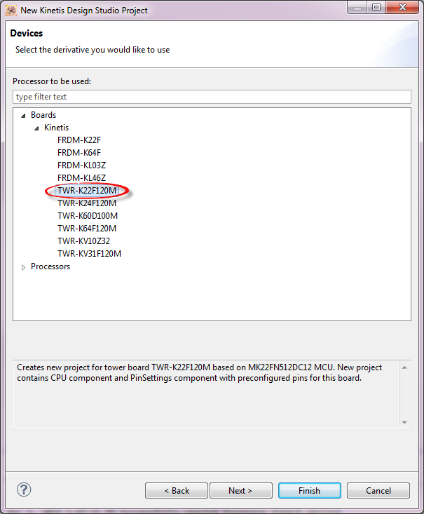

jverive
William,
The project is created using the Kinetis Design Studio Project wizard, selecting Board>Kinetis>FRDM-K22F in the Devices prompt. PE is not selected.
Where can I see where pins are being defined? Like I said, I have been using the Arduino family of devices, and there is a lot less "grunt work" that has to be done to use GPIO pins. I realize that the Arduino IDE is hiding most/all of the register/pin configuration process, and I don't mind doing it explicitly for the K22F, but as a new KDS user (and new to Kinetis micros and boards) this is all very confusing to me. That's why a demo would be so helpful.

jverive
Okay - board.h has an #include for _gpio_pins, so I commented out the enum { }; in my program. The redeclaration error goes away, but now I get
fatal error: fsl_gpio_common.h: No such file or directory
Indeed, no such file exists anywhere in my KSDK distribution (at least File Explorer's Search function can't find it. The file is referenced in a 'pin_mux.c' file that I am warned not to modify, as it is system generated.
It seems like it's one step forward, two steps back every time I think I'm making progress. Can you sense my frustration?
