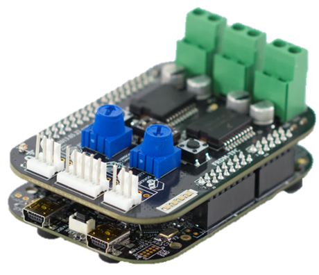

This document shows the ease of use of the peripheral drivers from Kinetis SDK applied to the Freescale Cup smart car. This time I bring to you a document which explains how to make the line scan camera with KSDK works step-by-step. This document is intended to be an example for the ADC, the PIT and the GPIO peripheral drivers usage.

The document Create a new KSDK 1.2.0 project in KDS 3.0.0 explains how to create a new KSDK project for the KL25Z MCU. The result of this document is the project BM-KSDK-FRDM_KL25Z.
The document Line scan camera with KSDK [ADC + PIT + GPIO] explains how to implement an application to acquire the data provided by the line scan camera. The result of this document is the project BM-KSDK-FRDM_KL25Z-LINE_SCAN_CAMERA.
