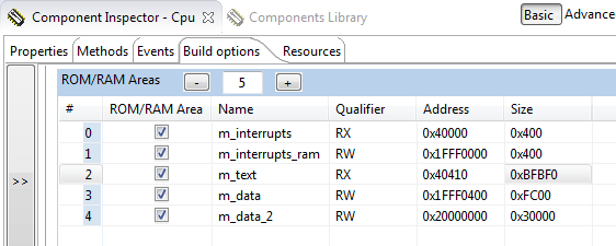

I recently upgraded to KDS 3.0 with SDK 1.2.0
I notice the following problems/limitations when I create projects with the SDK support. I am wondering if this is normal:
- I am trying to link all the code and interrupts at address 0x40000. My boot process already includes a resident bootloader at address 0x00000. That bootloader transfers control to code and interrupts at address 0x40000. However, when creating code using the SDK, the interrupt section always seems to be linked at address 0x00000, event though it is defined in Processor Expert to be linked at address 0x40000. Is that normal? Can that behavior be overcome?

1- If using Processor Expert you can change the memory segments from the CPU properties -> Build Options -> Generate Linker file. Picture below is for a K64FN1M0 target with the 0x40000 offset:

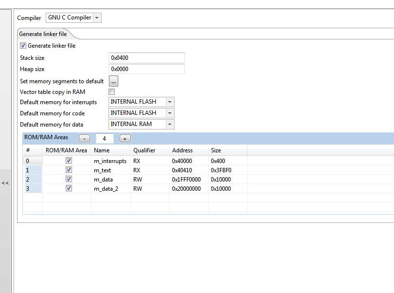

OK for all your answers, except the first one. I already configured the memory segments properly (see picture below)Capture.JPG
Nevertheless there is an interrupt section created and loaded at address 0x000000 in the .elf file.
I am suspecting that the tools assume that the CPU is cold booting and that something must be at address 0x0 at least for long enough to allow a copy of the interrupt section that I assigned at the correct address (0x40000)... But I am far from sure, and in any case I am not in a cold boot situation, so if that is the problem, how can I do to bypass that?
Bruno

With those settings from the CPU there should be no code located at address 0x0. But I made some tests and this may be the flash configuration area that is causing problems. From your project please navigate to SDK -> platform -> devices -> [DEVICE] -> startup -> startup_[DEVICE].S. You will find a flash configuration section, something like this:
Delete it or comment it all and clean -> rebuild the project. Let me know if this gets better results.

Indeed that seems to be the section that causes the problem. When I comment that part, there is nothing at address 0x0000 anymore.
This being said I do not fully understand why (maybe you can explain):
The linker file includes (forces) a m_Flash_Config section, but it is at address 0x00000400, as it should be. Why is it then that decommenting that code creates a section at address 0x0000, which by the way looks very much like an interrupt section, rather than a Flash_Config section.
Bruno

This is the behavior I see (considering the above memory offsets):
A) m_flash_config section in linker file + Flash configuration defined in startup file: The flash configuration is placed at 0x0400.
B) m_flash_config section removed + Flash configuration defined: The flash configuration is placed at address 0x0000.
C) Flash configuration commented out in startup file disregarding of linker file: No flash configuration in the binary/elf.
You should go with (C), but if you require a special flash configuration make sure to define it in the bootloader project.
I guess PE forces the m_flash_config section precisely to avoid case (B), but if you comment out the flash configuration then the linker does not find anything to place in that memory segment.
