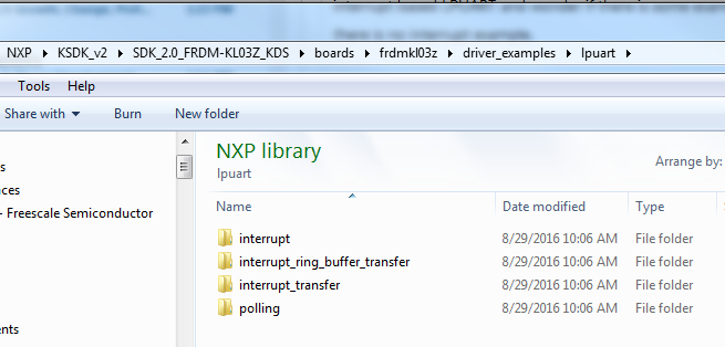

I have tested some example code for non-blocking and blocking LPUART drivers. However I want to do an interrupt based LPUART and wonder if there is some example code to go through ?? So far for SDK 1.2.0 there is no interrupt example.

KSDK_v2 (http://www.nxp.com/ksdk) install for KL03Z has LPUART examples for interrupt mode.
