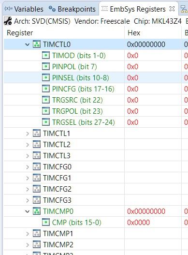

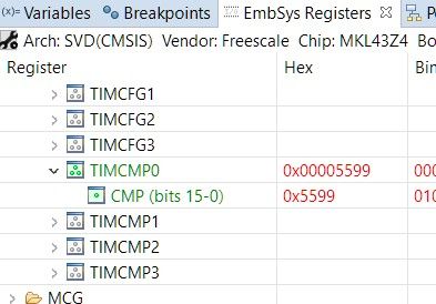

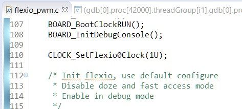

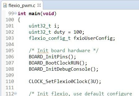

shauldorf
Contributor V
Hello David;
Run with FlexIO = 3U  line 110
Run with FlexIO  = 1U
I'm using windows 10
PEMicro :  MSD-DEBUG-FRDM-KL43Z48M_Pemicro_v118.SDA
Shaul

DavidS
Hi Shaul,
I can read the registers and see them update when I hit breakpoint with either clock configuration (1 or 3).
I'm still wondering if your KSDK is slightly older than mine.
To test I cloned the example as an standalone project.
Un-Zip to : C:\NXP\KSDK_v2\SDK_2.0_FRDM-KL43Zb_KDS\boards\frdmkl43z\user_apps
Have a breakpoint set at line 151 of flexio_pwm.c, open the EmbSys Registers window and see if you see TIMCMP0 updates:
This is with line 137 set to:    CLOCK_SetFlexio0Clock(3U);         //DES was (1U);
David

shauldorf
Contributor V
Hello David
Thanks for your support
In my application I’m using FRCDIV and LIRC_DIV2 to get low PWM Duty Cycle.
By doing few experiments with FRCDIV and LIRC_DIV2 setup, I found that if total division is greater than 128 x 2 or 2 x 128 I can’t read FlexIO registers.
I tried this on flexio_pwm_frdmkl43z demo and my bare-metal test.
In my test I have used KExTools v2 for pin_mux and clock_config generation.
I have also replaced the flexio_pwm.c with my code I got same behavior.
Is there any restriction on total division generated by FRCDIV and LIRC_DIV2?
Shaul

shauldorf
Contributor V
Hello David
Using this API I can change FlexIO clock but there is a problem in debug mode when you use MCGIRCLK reading  FlexIO registers returns zero. Reading from SIM or MCG is OK.
I have the problem in my test and I have verified it using NXP demo “flexio_pwm_frdmkl43z4” by changing the clock at line #110 of the source code.
Shaul

DavidS
Hi Shaul,
Hmmm.
Is the SIM_SOPT2[FLEXIOSRC]=3 when you are trying to read the FlexIO registers?
My clock config for the FlexIO is at line 137:
I just downloaded this KSDK_v2 for frdmkl43z.  I wonder if it is newer than your version?
I am able to see the FlexIO registers in the EmbSys Regiser window.  I tried both PEMicro and JLink successfully.

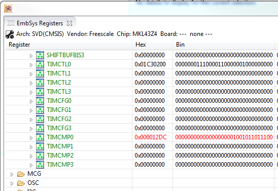

5,944 Views
shauldorf
Contributor V
David I forgot to mention that the problem is reading.
Writing to FlexIO register is O.K.
The same problem I have with my bare-metal program that I wrote.
I have PWM output and I can change duty cycle by writing to CMP register.
Shaul
