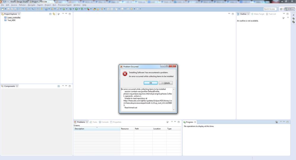

Hello!
When trying to install the KSDK into Kinetis IDE 3.0 I get the following error.
An error occurred while collecting items to be installed
session context was:(profile=DefaultProfile, phase=org.eclipse.equinox.internal.p2.engine.phases.Collect, operand=, action=).
Unable to read repository at http://freescale.com/lgfiles/updates/Eclipse/KDS/binary/com.freescale.processorexpert.ksdk-1.2.0.sp_....
Read timed out
What should I do in order to be able to install the KSDK?
Thank you!
Vlad

Hi Vlad,
you might try the workaround described in Workaround for “Installing Software has encountered a problem” in Eclipse | MCU on Eclipse
and disable that 'contact all update site' options?
I hope this helps,
Erich

reviciv
Thank you!
This worked great on the PC i intended to install the SDK originally.

Hello Vlad,
please, have you followed exact procedure for installing KSDK to KDS?
I mean this part : KDS V3.0.0 User´s Guide page 63
If yes and issue persists, please send me screenshot of the error.
Thank you,
Iva

reviciv
Hello!
I have seem to found the source of the issue which was a weak internet connection. Thank you for your assistance.

reviciv
Hello
Thank you for your reply. I have followed the exact procedure of installing KSDK to KDS however the error persists.
I have attached a screenshot of the error.
