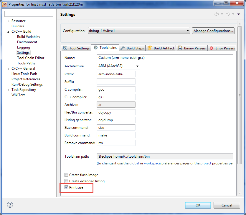

After doing that you can print size of the project
In my case - I did Optimization for the KSDK demo without optimization None (-O0),
before optimization there was result
and after setting optimization for all libraries (building as well) and project with option Optimize size (-Os)
there was this result
Be careful and consistently test the functionality of your code
