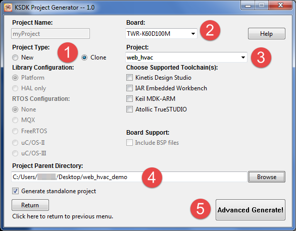

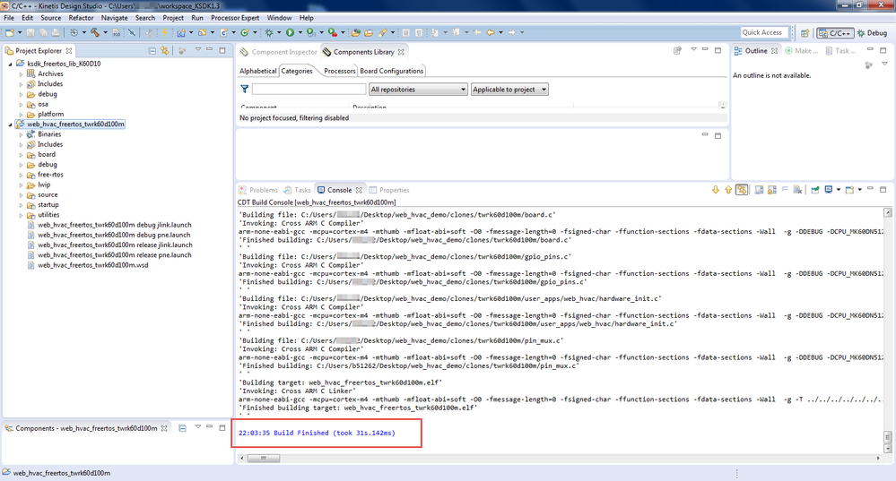

When you need to create copy/clone of i.g. web_hvac example for FreeRTOS as standalone project, you can face this issue.
It is impossible to work with the copy.

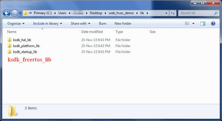

Why? There is missing folder for RTOS and LIB.

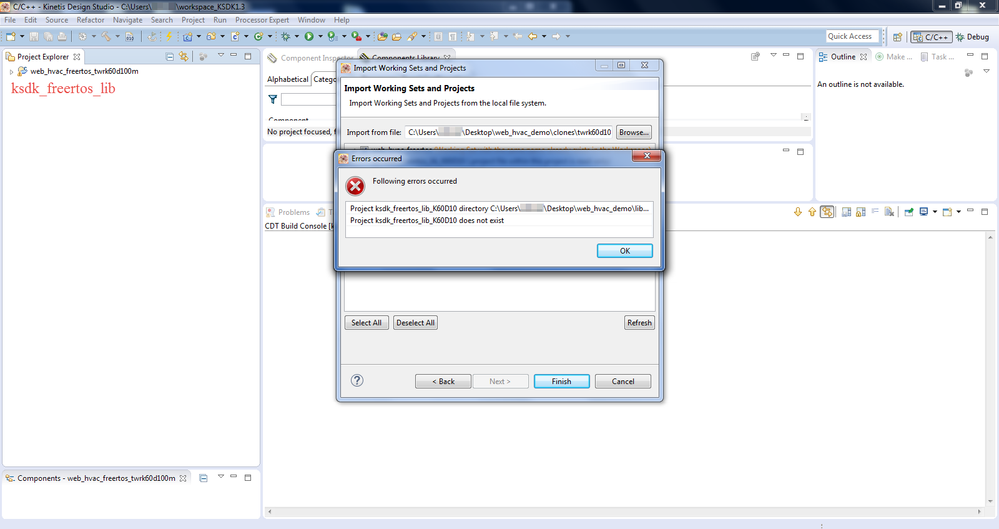

ISSUE:
You start to clone example

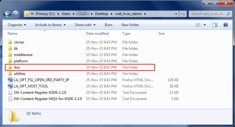

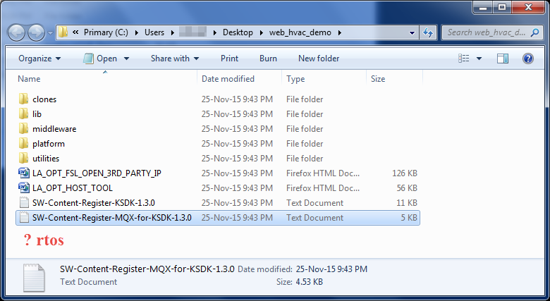

Also missing library ksdk_freertos_lib which is needed for the example
Impossible to compile the project, because folder mentioned above are missing in the project

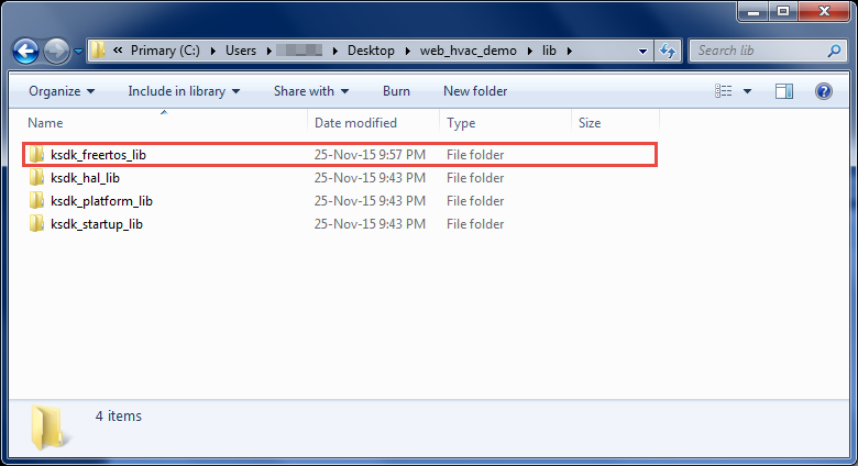

WORKAROUND:
Just add the folder rtos from C:\Freescale\KSDK_1.3.0

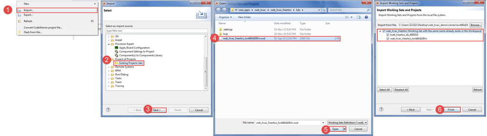

The same for the library, you add to the folder from C:\Freescale\KSDK_1.3.0\lib
Import .wsd file

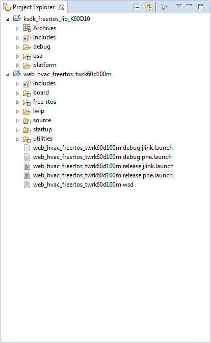

Wsd file was successfully imported, library is included
Build successful finished
I hope this helps you.

Hello Allen,
unfortunately not.
The issue occurs when you generate project as standalone project.
When you generate project to user_apps folder, there is no issue and it works without problem.
