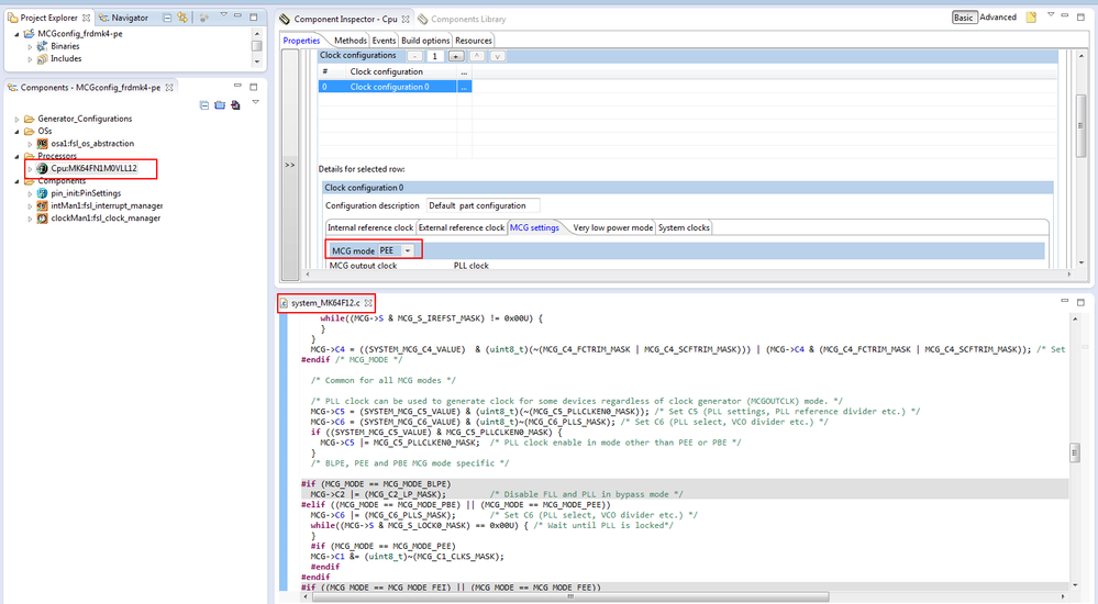

1) About the defauld MCG related configuration of  KSDK demo , its in here  "in startup -> sys_MK64F12.C".
Also, you can create a PE project ,then configuration the clock , refer to the generate code  ,like this:
2) Use the KSDK driver configuration the MCG, you can refer to the "C:\Freescale\KSDK_1.1.0\doc\Kinetis SDK v1.1 API Reference Manual.pdf\34.2 MCG HAL driver" .
We can configuration the CLOCK through these two methods according to our need.

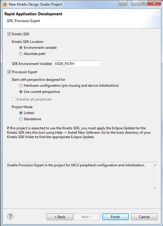

1) Can you tell me how you have conifgured the PE project for the K64 which you show the screen shot?  I am using KDS 2.0.0 with updates for PE and PE_K22.

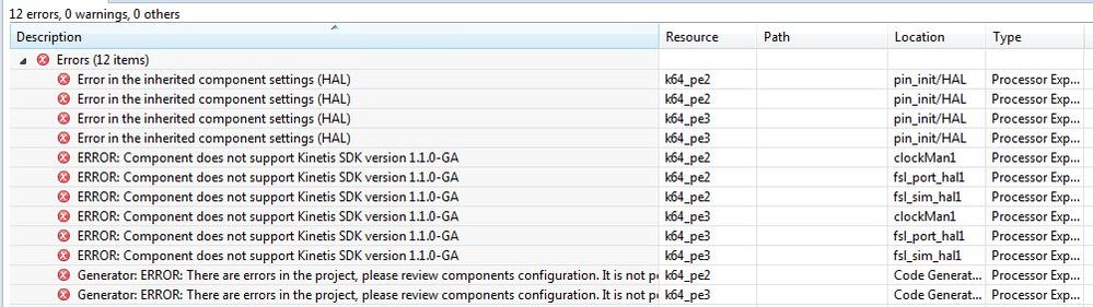

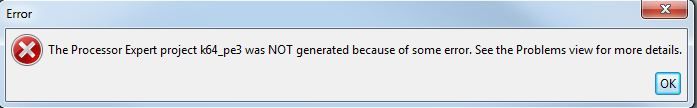

2) are you using the "Kinetis SDK" and "Processor Expert" options as shown in my figure1?  I am getting an error in project creation when enabling both options.  The errors shown in figure 3 seem to inidicate that I the SDK is missing an update?
My PE project creation steps when using KDS 2.0.0 with PE update and K22 update:

Pay attention , the Clock configuration is complete on the "system_MK22F.c". And after create project ,if you want
change the clock,  on one hand ,you can change on the file (In my own opinion , this methed is better);
On the other hand , you can use the SDK function ,its in here  : " Kinetis SDK v1.1 API Reference Manual.pdf\34.2 MCG HAL driver ".

Thank you for the information.  Indeed my problem was that I had installed the PE_KDS eclipse update from the KDS updates download pagge, where I needed to install the version locally from "KSDK_1.1.0\tools\eclipse_update".  All is working as expected now.
Cheers.
