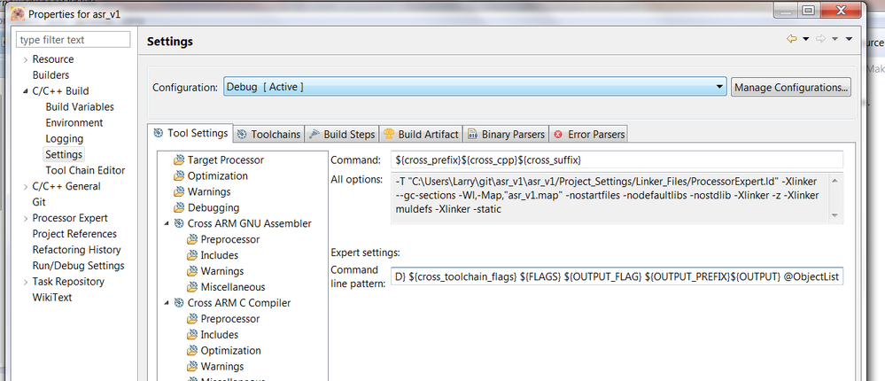

Here is a good work-around to this problem.
First, create a textfile called makefile.defs in the project's root directory. This file is referenced in the autogenerated makefile in an include statement as shown and is provided for the developer to influence an auto-generated make.
ifneq ($(strip $(S_UPPER_DEPS)),)
-include $(S_UPPER_DEPS)
endif
endif
-include ../makefile.defs
# Add inputs and outputs from these tool invocations to the build variables
# All Target
Use this file, makefile.defs, to copy all the compiled object files and libraries into a file which we called ObjectList. The makefile script we used is:
$(shell rm ObjectList)
$(foreach obj, $(OBJS), $(shell echo $(obj) >> ObjectList))
$(shell echo $(USER_OBJS) >> ObjectList)
There is probably a more efficient script than this but I'm not a script wiz.
Finally, edit the project linker settings' Command Line Pattern to remove the reference to $(INPUTS) and replace it with @ObjectList
Hope this helps.

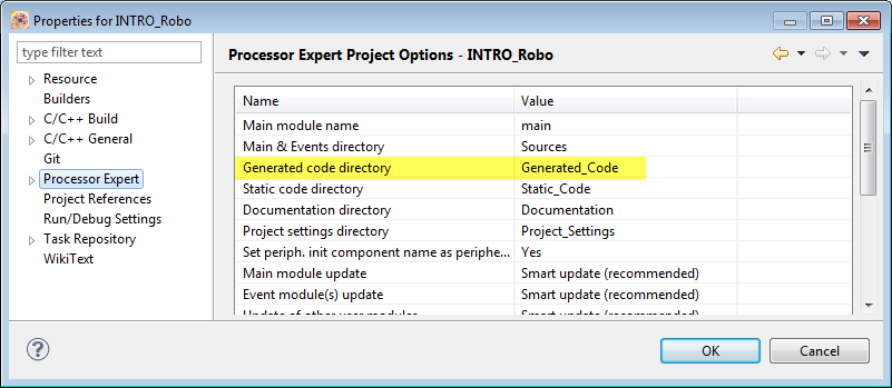

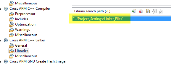

This probably only helps a little, but here a few tips to reduce the length of the command line:
a) use short paths/folder names (of course).
b) Shorten the folder for the Processor Expert generated code: there is a setting in the project properties:
c) Instead of "${ProjDirPath}/Project_Settings/Linker_Files/ProcessorExpert.ld" for the linker file (which will be expaneded to full path, do this:
Make the library search path relative (it is relative to the Debug/output folder):
Then you only specify the linker file:
That does not solve the problem itself, but maybe keeps the number of characters on the command line short enough.
