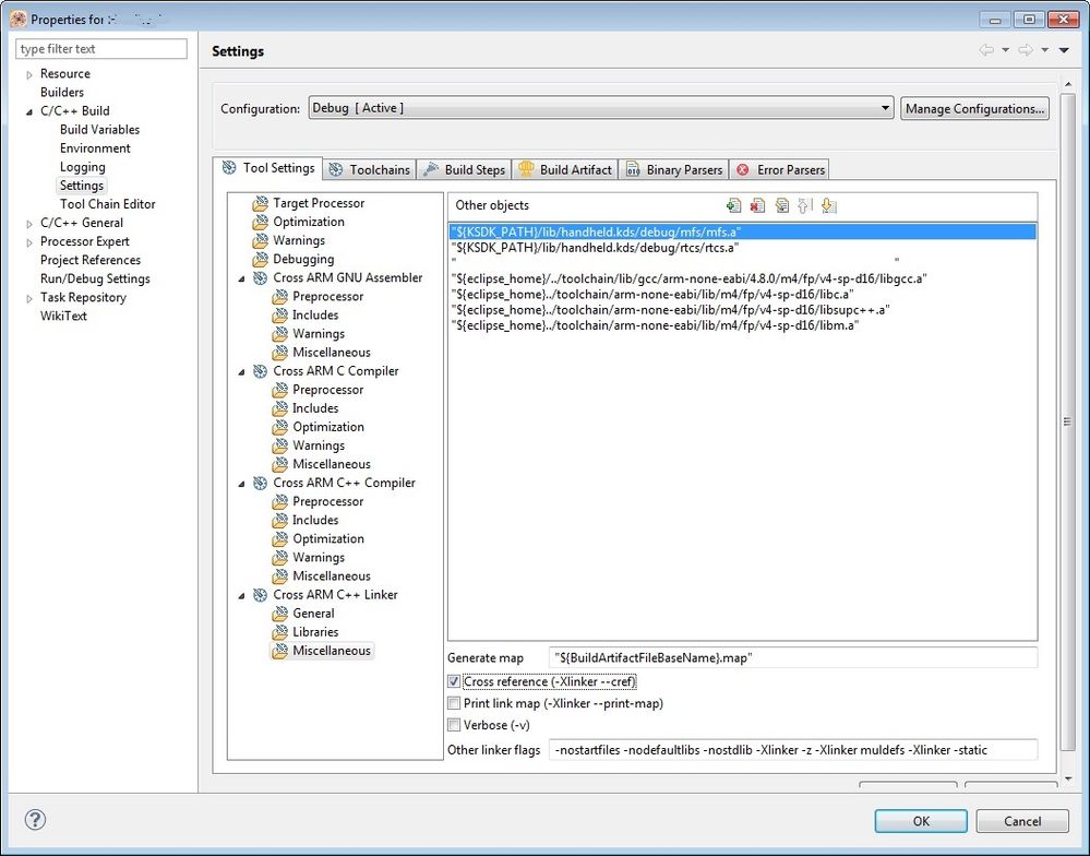

I figured out that exactly ONE character is removed from the command line string, which is always at the same position!
I added three dummy characters to the path string which was not found anymore. In the result the position where the character is missing has moved by three!
So I added a long empty entry in     property setting > Cross ARM C++ Link > Miscellaneous   just before the library which isn't found and now the linking works fine again.
(see the picture)
I know, this is just a quick hack but it works for the moment until the bug is fixed.

I just had a look at the command line.
The missing character is exactly at position 8192 of the parameter string (whithout the command "arm-none-eabi-g++")
So it seams that there is a problem if the created parameter string is greater than 8k bytes...
Bye Springer

This hack works on my project as well. Hopefully someone with more knowledge with the tool can help out here and give us a real fix.
Really good catch. Thanks.
