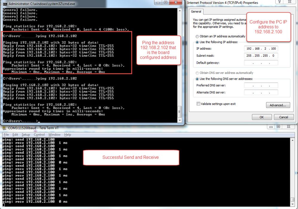

I'm trying the various ethernet-related examples of the KSDK 1.1 (lwip_ping_demo, lwip_httpserver_demo; I tried the bm and rtos code for the armgcc toolchain) on FRDM-K64F; no success, cannot connect/ping to the board, no output on the serial
after a bit of debugging I concluded that the ENET RX interrupt hander is not called, but why?
similar examples on mbed work OK for my board
is the example code supposed to work?
thanks, p.

I tested the code lwip_ping_demo and configured the IP address according to the information of the Kinetis SDK v.1.1 API Reference Manual Chapter 16 and it runs without problems.
Here is a picture that shows the demo running:
You mentioned you have no output on the serial, that means you cannot see anything in the COMx port connected to the FRDM-K64F SDA connector? I recommend to run a simple Hello_World demo  to ensure the Serial port is working correctly.

thanks for the confirmation; I got the examples working (most of the time at least)
the green LED on the FRDM-K64F RJ45 did not come up in one of the tries, not sure what is to blame
I cannot reproduce the issue anymore
