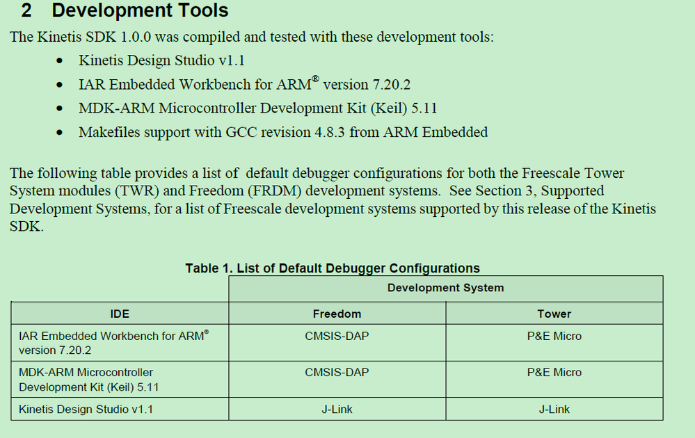

I have downloaded said software.
Question how do i access it?
Any docs to go with it?
How do I update Eclipse?
How do you run the demos?
I have tried numerous ways with the beta software, but none seem to work?

Hi George Michie,
    Thank you for your interest in our kinetis product.
    The KSDK-1.0.0 you have downloaded is the newest SDK version.
    You can use the IAR, kds or MDK to access it, this is already mentioned in our kinetis SDK release Notes.pdf.
About  your question, I think you should read some SDK document carefully before you enter in the SDK demo code.

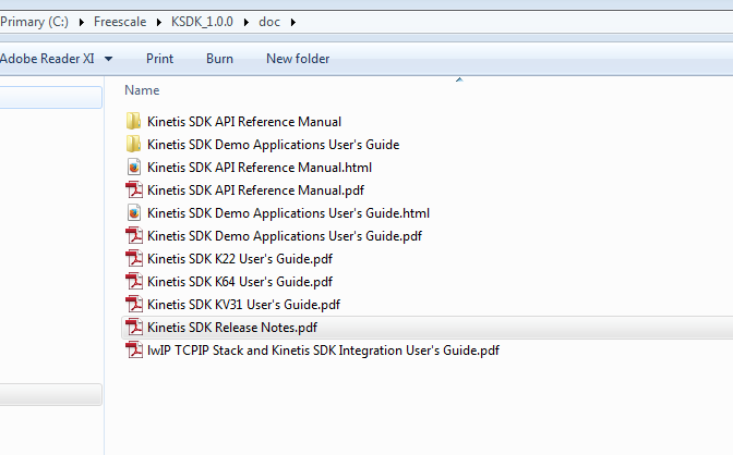

After you install the SDK , you can find the useful documents under the default path: C:\Freescale\KSDK_1.0.0\doc
Wish it helps you!
If you still have quesiton after you read the document, please let me know!
