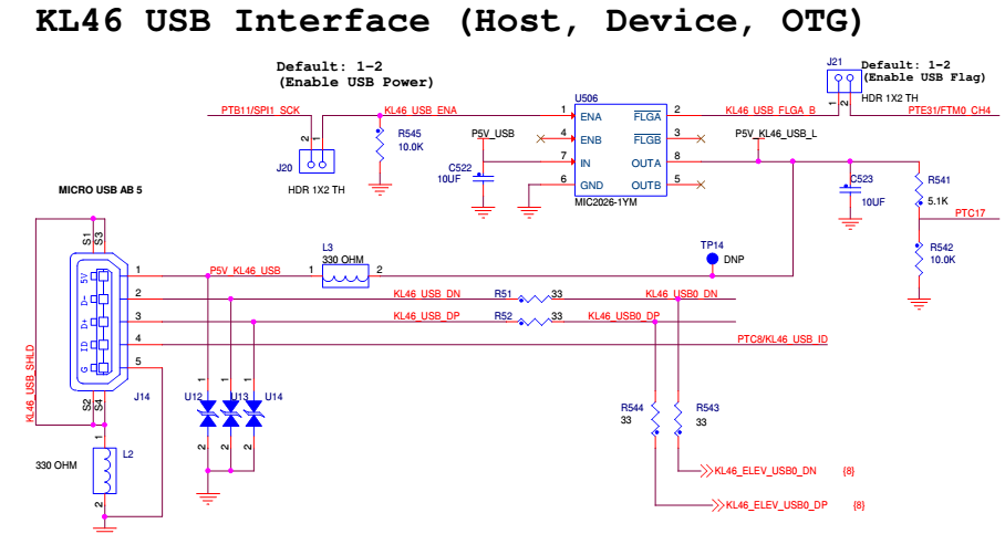

I'm trying to use TWR-KL46Z48M as USB Host for MSD.
I've tried examples given in C:\Freescale\KSDK_1.1.0\usb\example\device\ for USB mouse and USB keyboard and they work fine.
But while in a host mode, running the demo from C:\Freescale\KSDK_1.1.0\usb\example\host\ , the board is not being able to detect USB device attached to it via micro-USB connector. device_state is always being shown IDLE in APP_Task() call. I've checked all the jumpers setting required for hosting USB device on board. Am I missing something here??
Please let me know if there is any additional requirement to be fulfilled for the board to host a USB device, any additional API to be invoked or something else.

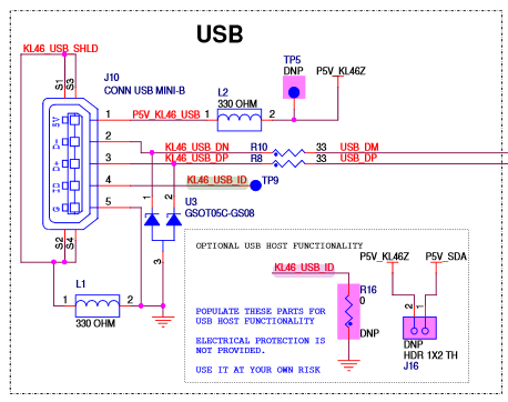

Hello Rini Patel,
I´m sorry for confusing, I read FRDM-KL46Z. Unfortunately TWR-KL46Z48M is not supported in KSDK 1.1. neither KSDK 1.2.
Because of different pin configuration, there is considerable explanation.
For FRDM-KL46Z is needed KL46_USB_ID to ground through unpopulated resistor
while for TWR-KL46Z48M is KL46_USB_ID connected to PTC8
And it is the reason, why TWR-KL46Z does not work on FRDM-KL46Z.

rinipatel
Hello Iva,
Yes I've tested the HID demos located at C:\Freescale\KSDK_1.2.0\examples\frdmkl46z\demo_apps\usb\host\hid\  using KDS_3.0.0. But getting the same issue. USB mouse/keyboard device state is always being shown IDLE. Same for the MSD(2 GB u-disk). Keyboard and MSD are not even getting powered up..

rinipatel
Hey Iva,
This worked for me.
By providing KL46_USB_ENA signal via PTB11 gpio pin, TWR board is able to provide 5V VBUS to OTG connector and the FRDM-KL46Z USB Host demo code is now working for TWR-KL46Z.
Thanks!!. :smileyhappy:

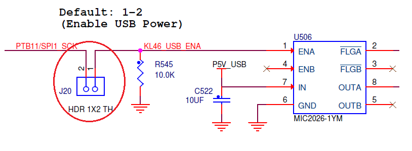

neoxiong
Hello.
For the host application, the VBUS must be provided by TWR-KL46Z48M board. May be you should check below jumper or measure the VBUS signal of OTG connector.

derek_lau
The USB_ID pin can be used to indicate whether KL46 acts as a USB host or device.
USB_ID = 0, KL46 acts as a USB Host. Therefore, when PTC8 with pull-up goes low for a certain period of time, it can provide 5V output by setting the PTB11 pin to one. Or you can force to generate 5V output without checking the USB_ID pin.

rinipatel
Measuring the signal from pin 7(P5V_USB) and GND of U506, I'm getting ~4.6V, but from the pin 8(OUTA) and GND it's  ~2.8V. So Micro-USB connector is only getting 2.8V P5V_KL46_USB signal. Why is this happening, what needs to be changed to generate ~5V P5V_KL46_USB signal for host operation?
My current jumper settings are:
J18: 1-2 -> P5V_KL46_USB
J20: 1-2 -> KL46_USB_ENABLE
J21: 1-2 -> KL46_USB_FLGA
