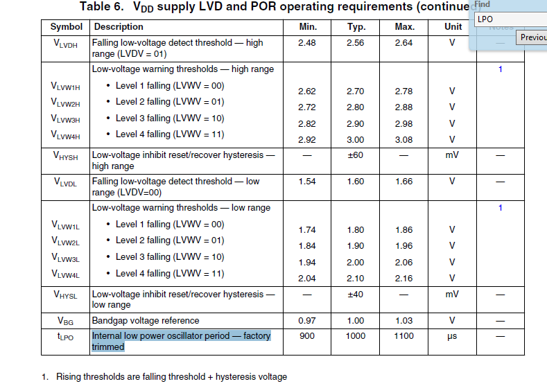

Regarding your question that "My application sets a LPTMR interrupt using the LPO (1kHz) clock, but when I set, e.g., a 1 second interrupt, it triggers every 1.2 seconds.", I think the LPTMR interrupt period accuracy is only dependent on the LPO clock accuracy, as you know that the LPO is inaccurate, pls refer to section 2.2.2 LVD and POR operating requirements in data sheet of KL25, I copy it here:
so it is possible that you get 1.1S when you set the it as 1.0s
If you need accurate interrupt period with LPTMR, I suggest you use external 32.768KHz crystal.
