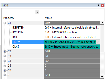

While debugging, I see that the CLOCK_SetSimSafeDivs() function correctly alters the SIM_CLKDIV1 register.
However, when CLOCK_BootToFeiMode executes, the registers won't change to the specified parameters. As an example, the DRST_DRS bit in MCG_C4 should be set to 1, but the function doesn't modify it and it still keeps the value 2.
Also, in the CLOCK_SetInternalRefClkConfig function, the MCG_C1 bit CLKS is not set to 1 to select the internal reference clock, but keeps the value 2, which selects the external reference clock.

Also, for my clock configuration code above, since I'm using the internal clock, shouldn't the IREFS and IRCKLEN bits on MCG_C1 be enabled?
Keil it shows that external clock is selected even after configuration:
Based on the Processor Expert generated code, IRCKLEN and IREFS should be 1 and CLKS should be 0.
If I try to manually write the values to MCG->C1, they won't work.
Any tips?
Gustavo.

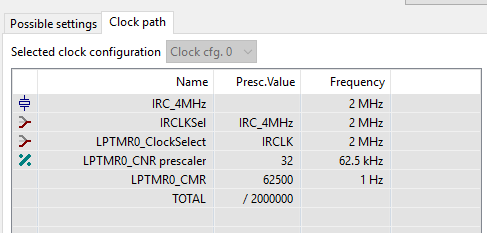

Thank you for your response.
Looking at my Processor Expert configuration which correctly triggers the LPTMR interrupt to trigger every 1 second, it selects the IRCLK (2MHz), prescales it to 62.5kHz and counts to 62500 to give 1Hz.
How can I achieve this same clock path configuration using KSDK? I attached a screenshot showing my PE configuration.
Thank you,
