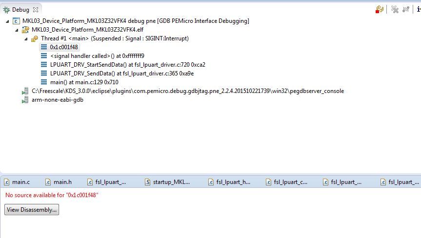

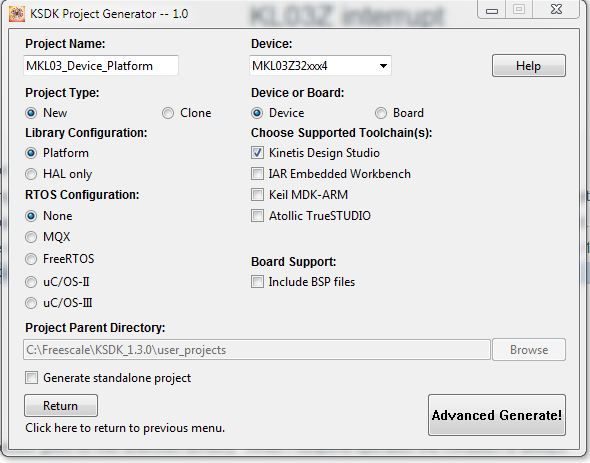

I created a project using the KSDK Project Generator 1.0 for a MKL03 MKL03Z32VFK4.  See image below.
I am trying to get the LPUART_DRV working using interrupts, but when the LPUART_DRV_SendData() runs it crashes when LPUART_BWR_CTRL_TIE(base, 1U) is run in function LPUART_DRV_StartSendData().  See attached image of the debug session.
Also, attached is the project.
I am missing something, but cannot figure it out.  Any advice as to why it is crashing would be really appreciated.   Thank you.

Jorge_Gonzalez
Hello Mike:
Do you still have this issue? Have you tried in standalone mode without the debugger?
I tested your project from my side with a FRDM-KL03Z and it worked as expected. From your screenshot it seems that the core is using the vector table from the ROM bootloader.
Try adding the next code before any application code is executed (e.g. in SystemInit() or at the beginning of main():
// Disable force ROM.
RCM_BWR_FM_FORCEROM(RCM, 0);
// Clear status register (bits are w1c).
RCM_BWR_MR_BOOTROM(RCM, 3);

aes_mike
Jorge,
Thank you for the tip!
Turns out in the startup_MKL03Z4.s I had:
/* Flash Configuration */
    .section .FlashConfig, "a"
    .long 0xFFFFFFFF
    .long 0xFFFFFFFF
    .long 0xFFFFFFFF
    .long 0xFFFF39FE
it ought to be:
    .long 0xFFFFFFFF
    .long 0xFFFFFFFF
    .long 0xFFFFFFFF
    .long 0xFFFF3BFE
Mike
