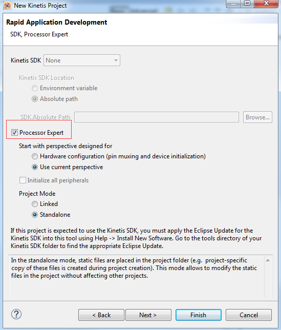

Hello all.
In 2012 - 2013 I did a couple of projects with the K70 & K20 using CodeWarrior 10.3 and 10.5.
I am now trying to use KDS to start on another K70 project.
I am unclear as to what I might be missing without K70 support in the SDK. If I use PE, this is all moot?
But doesn't the SDK provide things that I would need developing for the K70?
Sorry but I am a little confused.
At the moment I feel this new setup is a bit of a mess. I tried using CW 10.6 to reload a couple of old projects but CW complained that they had been moved and couldn't load them correctly.
Please advise!

in addition, per current KSDK road map, K70 will not be included in KSDK 1.3 either.
KSDK1.3 is scheduled to be released on the end of this Q3.

Hello Phil,
(1)  So far, the KSDK haven't support all of the kinetis chips , and the latest version KSDK1.2 have not support K70 .
  And if you want to use KDS develop K70, now you can sue Processor Expert .
(2) When you open the CW10.5 project on CW10.6 ,does it error ? What's error ? please screenshot it and show us.
And what about your project , with MQX ? or with PE ? or ...
Alice
