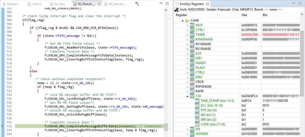

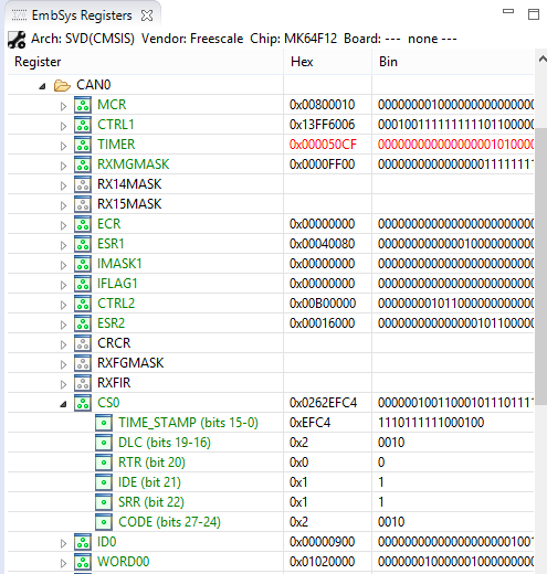

I am attaching screenshots of the CAN0 register contents before and after the hardfault:
After returning from the IRQ handler, we see that the IMASK AND IFLAG for MB0 have been disabled. There no errors in any of the CAN registers. 900 and 0x01, 0x02 are the correct data in WORD0.
