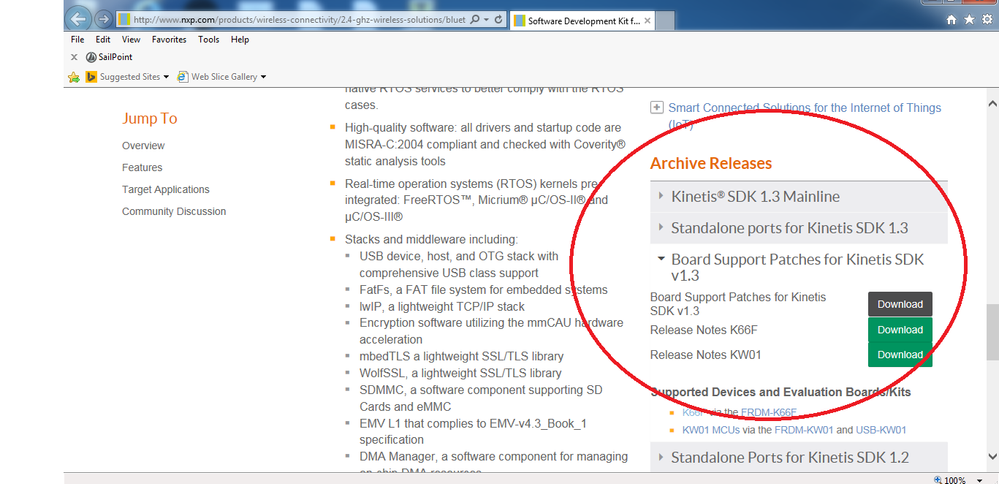

xiangjun_rong
Hi, Ben,
you can download the SDK1.3 from the link:
https://community.nxp.com/thread/445220
after you go to the website, pls check the right/bottom coner of the website, you will see the screenshot, you can download SDK1.3:
Hope it can help you
Xiangjun Rong
