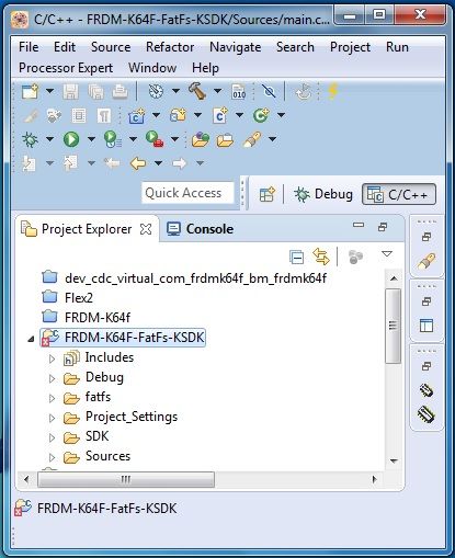

I was able to find the previous errors (not finding the .h files).
Apparently, the following paths are like so:
"${KSDK_PATH}/platform/drivers/inc"
"${KSDK_PATH}/platform/osa/inc"
"${KSDK_PATH}/platform/hal/inc"
"${KSDK_PATH}/platform/system/inc"
In my project, I had to do the following:
"${PROJECT_KSDK_PATH}/platform/drivers/inc"
"${PROJECT_KSDK_PATH}/platform/osa/inc"
"${PROJECT_KSDK_PATH}/platform/hal/inc"
"${PROJECT_KSDK_PATH}/platform/system/inc"
That fixed the issues of the .h files, then I went back and removed the .h files I added to
satisfy the previous errors.
Now, I after compiling I get the following:
and on my Console, it reports this:
make: *** No rule to make target `/lib/ksdk_platform_lib/kds/K64F12/debug/libksdk_platform.a', needed by `FRDM-K64F-FatFs-KSDK.elf'.  Stop.
I think it has to do with this portion of the demo step:
2.11 Go to Project -> Properties -> C/C++ Build -> Settings -> Cross ARM C++ Linker -> Miscellaneous and add the KSDK platform library binary to “Other objects”:
"${KSDK_PATH}/lib/ksdk_platform_lib/kds/K64F12/debug/libksdk_platform.a"
so, I changed it to this, since the previous seems to have done the trick:
"${PROJECT_KSDK_PATH}/lib/ksdk_platform_lib/kds/K64F12/debug/libksdk_platform.a"
Unfortunately, this did not take care of it....??? Not sure what to do now!!!

Update:
Apparently:"${PROJECT_KSDK_PATH}/lib/ksdk_platform_lib/kds/K64F12/debug/libksdk_platform.a" was an issue,
the main issue though I was having was that I skipped this step:
4- Build the KSDK platform library for K64F. Refer to Appendix B - Build the KSDK platform library at the end of this guide.
After doing this, the x disappeared from the project file, so its time to debug.  I followed the debug instructions as instructed in the video:
 Debugging with KDS: https://community.freescale.com/videos/3283
I used the semihosting, changed the "other linker flags" to -specs=rdimon.specs, went through the debug configuration, but I am still having an
issue.
I am not sure if my issue is relating to this, but....... when I load the OpenSDA bean and I am using the P&E OpenSDA, I am loading the eval
board with DEBUG-FRDM-K64F_Pemicro_v108a_for_OpenSDA_v2.0.bin.
I will continue to try.......
