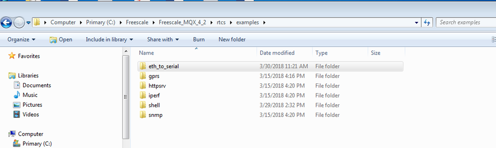

Hello, I saw in this post, https://community.nxp.com/thread/377941#comment-577390,  that there is a Ethernet to serial example application, which demonstrates a simple character passing between UART console and socket. I downloaded the latest SDK for the K64 Freedom board, SDK_2.3.1_FRDM-K64F but I could not find an example like that.
What would also be nice is an example of a web page server that can set and read port pins.
Any thoughts on where I can find examples?

Hi Mark:
The eth_to_serial demo is in classic MQX 4.2 RTCS stack, but not in SDK.
Regarding your web page server issue, we have a httpsrv demo, it demonstrates an HTTPServer on the lwIP TCP/IP stack , but not implement displaying/setting pin informaiton
SDK_2.3.0_FRDM-K64F\boards\frdmk64f\demo_apps\lwip\lwip_httpsrv
