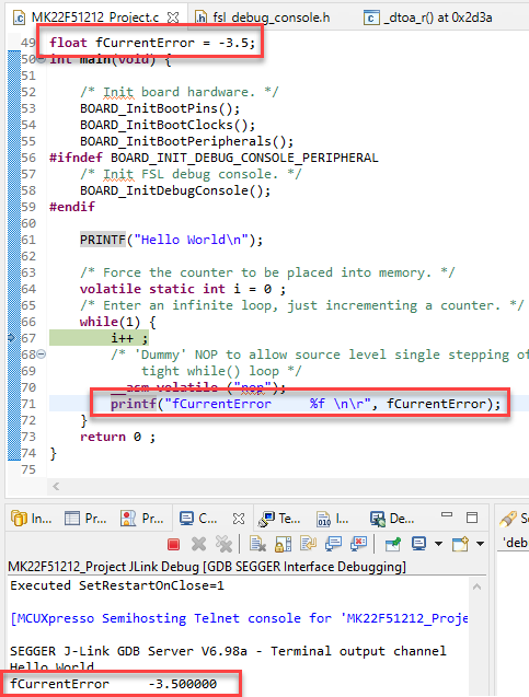

not fixed in MCUXpresso IDE v11.2.1 [Build 4149] [2020-10-07]
5,275件の閲覧回数
ErichStyger
Specialist I
Hi @docmo99

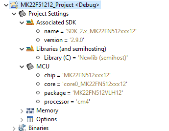

I would say it does not depend on the IDE, as the original report was about the SDK code. And the SDK has changed from the Kinetis SDK to the MCUXpresso SDK.
So: if you use say MCUXpresso IDE (11.3.1 would be the most recent one) then you probably use the MCUXpresso SDK 2.9.x. In essence: it is not about the IDE but the code/library you are using.
Further the floating point support depends on the standard library used. If using newlib-nano you have to turn on floating point support in the linker settings. For newlib it is automatically turned on.
If you decide to map your printf calls to the standard library, then it will use whatever is in the standard library, and I can confirm that floating point numbers are working as they should with this, for example:
Can you be a bit more specific and show with an example (and setting used) what is not working on your end?
