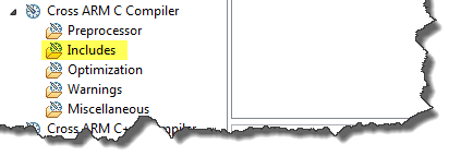

Please, go to Project -> Properties -> C/C++ Build -> Settings -> Cross ARM C++ Linker -> Libraries
and set  "${KSDK_PATH}/middleware/tcpip/rtcs/lib/frdmk64f.kds/debug/rtcs" in Library search path (-L)
and _rtcs in Libraries (-l)
And set the same path "${KSDK_PATH}/middleware/tcpip/rtcs/lib/frdmk64f.kds/debug/rtcs" also for Cross ARM C Compiler -> Includes
