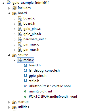

ivadorazinova
Hello Nelson,
better way is create new project with KSDK 1.2 selected option and remove what you do not need because you have included libraries in KSDK project.
For this case you can use GPIO example.
Every KSDK example has included board folder, which contains board.c/h, gpio_pins.c/h and pin_mux.c/h.
board.h is board configuration - contains specific macros as LEDs, push buttons...
board.c contains clock and oscillator initialization functions
gpio_pins.h/c - contains definitions which KSDK GPIO driver uses for the platform´s GPIO pins.
pins_mux.c/h - contains peripheral-specific pin mux configurations.These functions can be called by the
hardware_init() function or individually by the demo application.
Please, look at the example code,gpio example is located here <ksdk_path>\examples\<board>\driver_examples\gpio it is unnecessary to copy the code here.

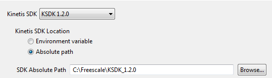

2,801 Views
nelsonlobo
OK. I just tried creating a project using KSDK 1.2.0 but it wouldnt let me to do so. I guess i have to install KSDK 1.2.0 Eclipse update inroder to do dat.
Now the issue is that everytime i try downloading this package it crashes with some error. Is there any alternative link to the same?
2,801 Views
ivadorazinova
for eclipse update is the only way.
Please, follow this procedure to Installing Kinetis SDK into KDS
If does not help, please, let me know.
I hope it helps you,
Iva
2,801 Views

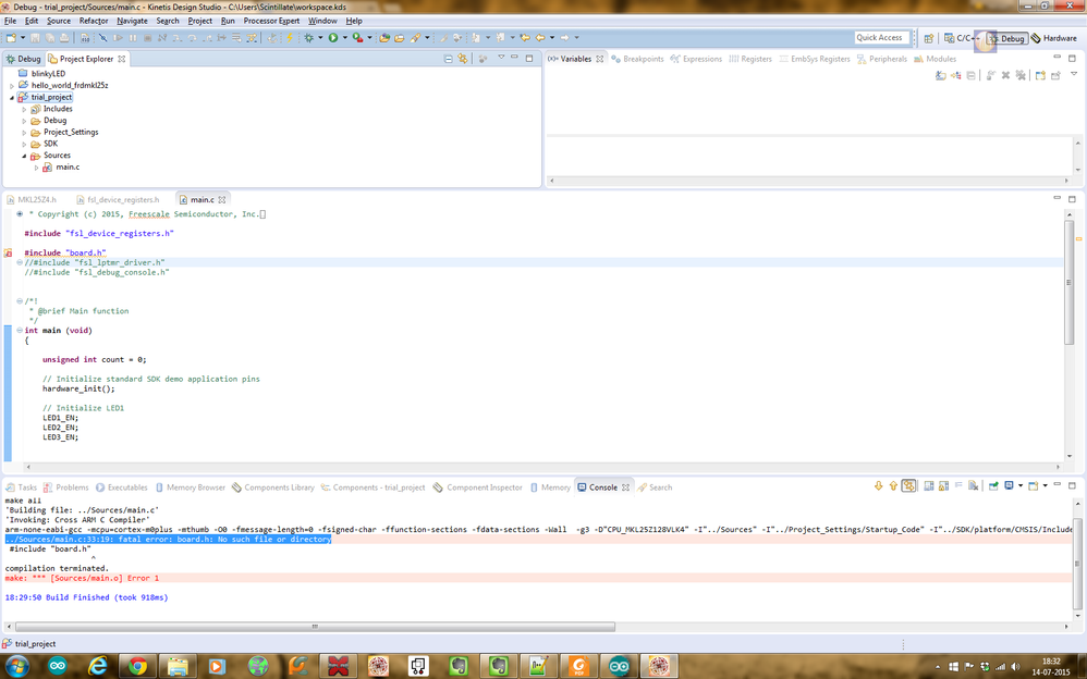

nelsonlobo
Hi Iva,
I have installed KSDK1.2.0 update. Also created a new project using KSDK1.2.0 from project creation.
The problem is that when i try to add board.h it throws an error stating ""../Sources/main.c:33:19: fatal error: board.h: No such file or directory"
As u notice the board folder is missing. How do you add the board folder that possesses all the board related libraries ?
