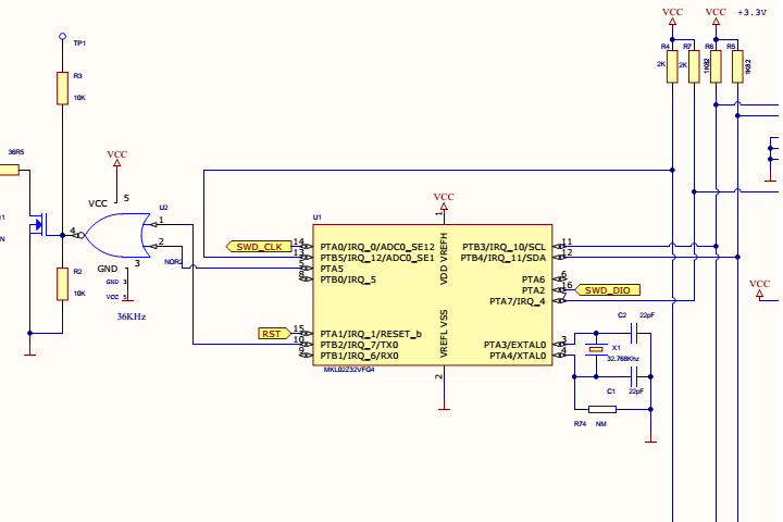

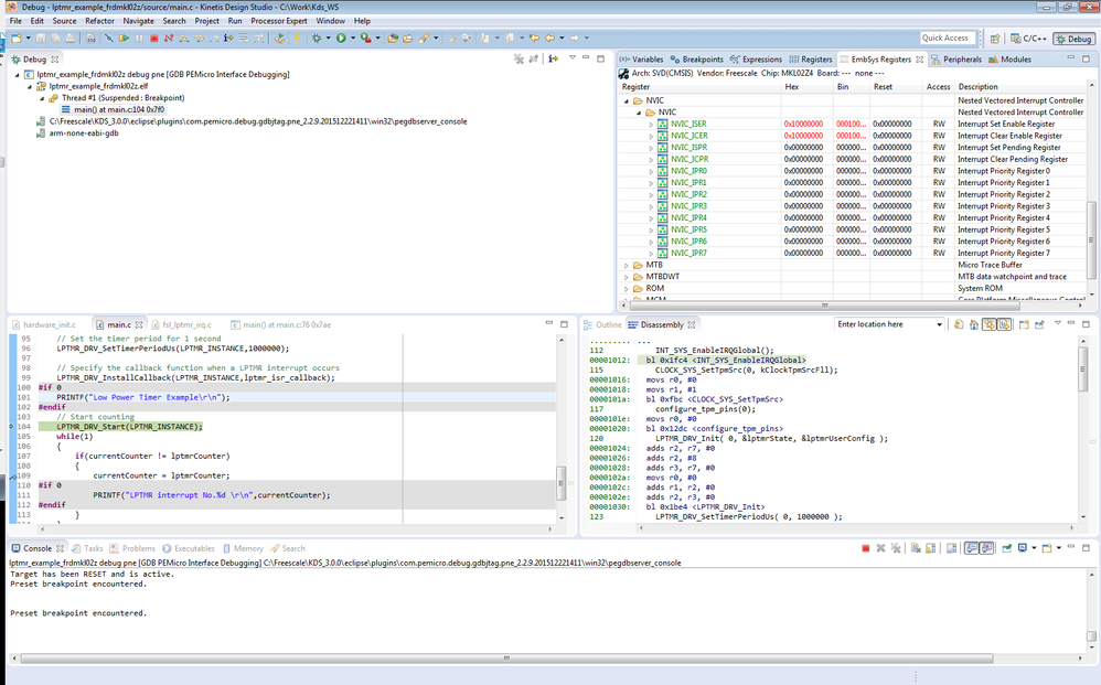

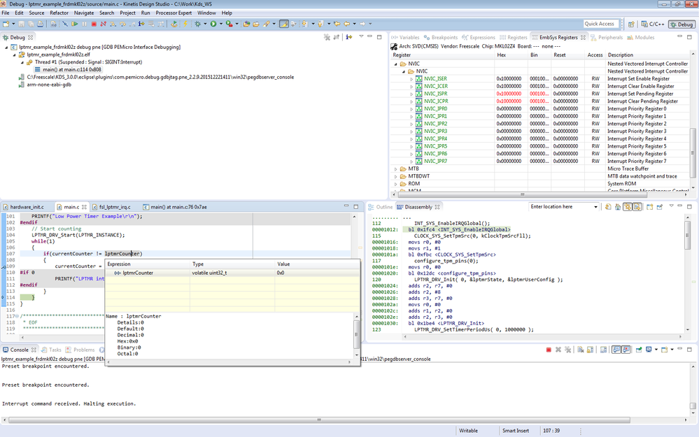

anther
Hi David,
Thanks for your help but the problem persist. I don't work with the eval board, I'm working with a propietary board based on MKL02Z32VFG4.
Today I tried the Freescale sample but this doesn't work. As unusual in my board I have tied to ground PTB5 but I've configured as GPIO with this line PORT_HAL_SetMuxMode( PORTB, 5, kPortMuxAsGpio);
These are the screenshot:
Before int: The LPTMR interruption is properly configured.
After int : The interrruption flag is set but the code doesn't jump to LPTMR0_IRQHandler function.
And this is a microcontroller part of my schematic:
Any ideas for how to fix this problem?

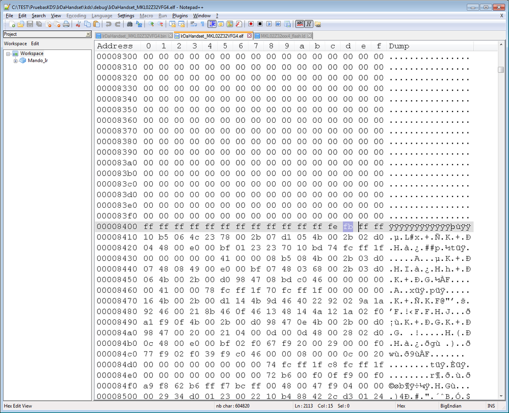

anther
Hi David,
Thanks for your help, I've cleared NMI_DIS bit and the program works perfectly.
As clarification FTFA is a read only registry and is not possible modifying its value as others in program code. This registry is loaded during the reset sequence from program flash at the address 0x400 ( in kl02 microcontrollers ). For this reason if you want to change the FTFA values you need to modify the values in the binary file.  A easy way to do this is modifying the values from startup_Microcontroller.s in my case startup_MKL02Z4.s
/* Flash Configuration */
    .section .FlashConfig, "a"
    .long 0xFFFFFFFF
    .long 0xFFFFFFFF
    .long 0xFFFFFFFF
    .long 0xFFFFFBFE
    .text
    .thumb
With the linker file you can verify the location of the section, in this case .FlashConfig and the files of this registry are in the specifc microcontroller header file. In my case MKL02Z4.h
To verify tha your code works properly, you can check the address 0x400 in the binary file:
