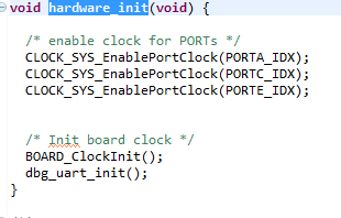

DavidS
Hi Koorosh,
I'm assuming you are using the KDS_3.1+KSDK_1.3 and the hello world for C:\Freescale\KSDK_1.3.0\examples\twrk64f120m\demo_apps\hello_world\kds .
I had to do the following modifications to get the TWR-K64F+TWR-SER working for UART5 to the DB-9 connector.
hardware_init.c
void hardware_init(void) {
  /* enable clock for PORTs */
  CLOCK_SYS_EnablePortClock(PORTA_IDX);
  CLOCK_SYS_EnablePortClock(PORTC_IDX);
#if 1 //DES 1=needed when UART5 of TWR-K64F used with TWR-SER card, 0=default code
  CLOCK_SYS_EnablePortClock(PORTE_IDX);
#endif

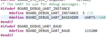

Sorry forgot the other capture. So I too have the same code, yet  terminal is mute.I'll scope it and see if anything coming out of the DB9 connector
board.h
There are some jumpers J10/J15 I've removed them but I don't believe they've anything to do with it

kooroshhajiani
Hi David,
Thanks for your response,
3,418 Views
kooroshhajiani
board.h
