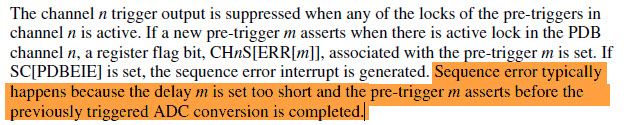

I've not checked deeper your code but it seems to be a Sequence Error on PDB, here is the bit status from PDB registers:
Please check this note (Section 39.4.1 PDB pre-trigger and trigger outputs):
And checking your IRQ handlers, you do a lot of stuff in every IRQ handlers (it is recommended to implement shorter IRQ handlers like setting flags, events, etc in order to avoid this issues). Besides, you configured PDB to count "1" Bus cycle in order to generate a new hardware trigger for ADC, so it takes aproximately 1/60MHz to generate a trigger (16nS) for ADC, are you sure that ADC's conversion speed is higher that this value?
