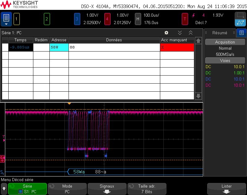

I talk with a PSU in a Task every 400ms, it works fine during a variable time (about 30 sec or 15 min) but after the I2C crash and only a software reset allow to restart the communication.

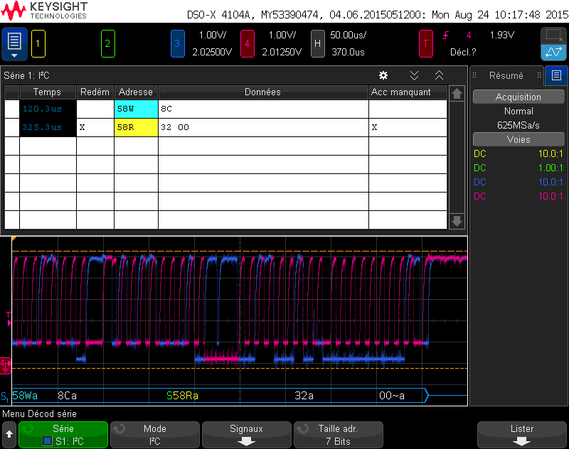

I take a screenshot when it works fine :

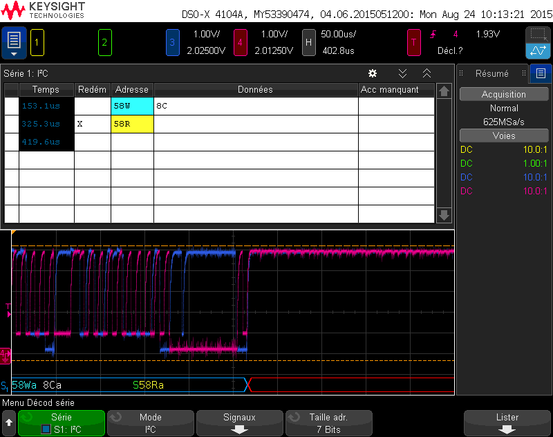

And a screenshot when the bus crash :
Why after the repeated start, only one clock was sent ? Whats the problem ?

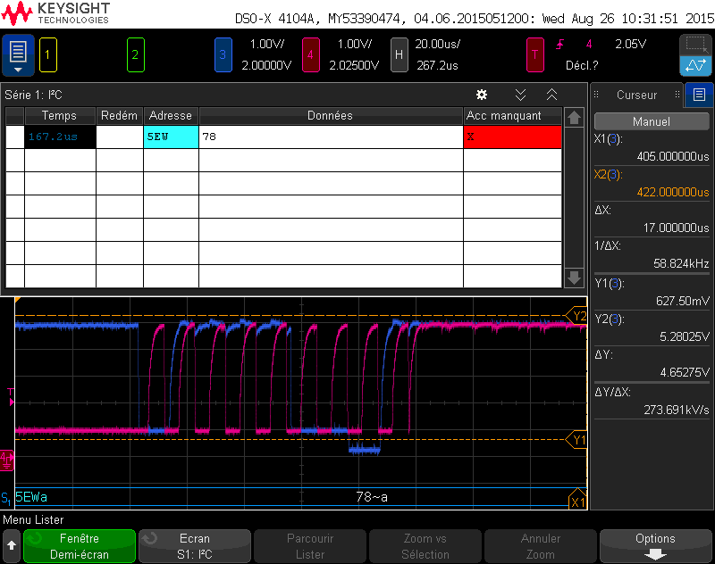

An another screenshot when the bus crash :
Can you help me ?

It fails with (2) and (3), but works OK in case (1). This implies that you should be looking at hardware issues with the I2C buffer instead of the software issue.

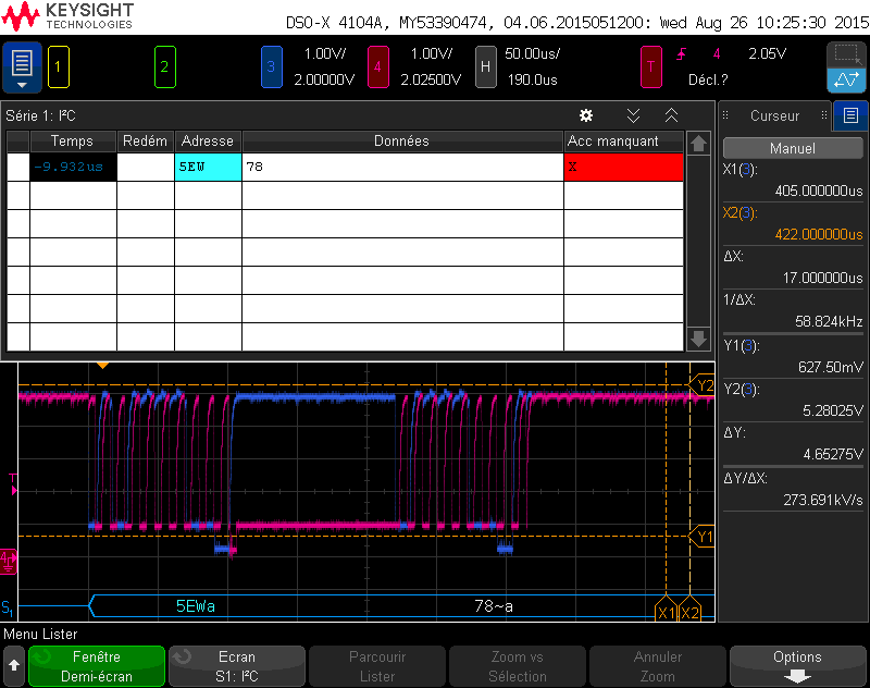

In your pictures I notice that the low level in SDA and SCL lines does not go all the way to '0' volts (or close), except for the acknowledge bit. Have you enabled the Open Drain configuration for both pins in the K64? If open drain is not enabled this could cause transmission issues.
Also, from your last 2 screenshots I think the slave holds down the clock line. This leads me to think that the problem is in the slave side. Maybe the frames are sent too fast or the slave requires warm times between transmission, or getting stuck because of an internal error, etc, there could be several reasons. Give a check to the slave specifications and try reducing the I2C frequency and/or adding delays between transfers.

Open drain is enable for SDA and SCL pins, but there is an explanation for the low level. I use two P82B96TD for increase I2C level to 12V during the transmission for reduce noise impact. When I take the screenshots, I placed sensors on the side of the PSU (exactly there is 6 PSU on the I2C Bus). But the P82B96TD can provide a minimum low level of 0.8V. So on the screenshot, the low level provide by the slave is 0V (because it is not yet passed through the two P82B96TD) whereas the low level provide by the K64 is 0.8V.
I tried to reduce I2C frequency or add delays between transfert, but the problem still occurs.
You said : maybe the slave holds down the clock line, but if it's really the slave, we would see on the screenshot a low level to 0V (not 0.8V) no ?
I have an another screenshot when the I2C bus Crash :
zoom on the second 8 bits :
I don't understand the behavior of the uc, the slave give an acquittement one clock too early, ok, it's not really a problem, but why the I2C bus crash ?

The early ACK could explain the problem. In your pictures when the ACK is sent on the 8th bit, the 9th bit is '1' (NACK). The KSDK I2C driver interprets any NACK as a failed transmission and immediately sends the STOP signal. I suppose that's what you mean with "the bus crash".
So, I still believe the issue is on the sensor side, maybe due to the I2C buffer (P82B96TD). If possible try connecting the sensors directly to the MCU, to discard a problem with the buffer.

On the last screenshot, the 9th bit is '1' NACK, the I2C driver interprets any NACK as a failed transmission, ok I agree with this. But on screenshot I don't see the stop signal, so I said "the bus crash" because after this frame, when I want to send another frames , the driver return "bus busy" and only a "deinit" and "init" of the I2C module can relaunch the communication.
Why the stop signal is not send ?
Could you explain the behavior after the 9th bit ? (indicate in the red circle on the following screenshot)
In addition, if we return on the second screenshot I posted :
On this screenshot there is no problem with "ack" but the bus crash and after this frame, the bus state is "bus busy" and I can't communicate.
Why the I2C module stop after send only one clock ?
Why during the clock stretching, the sda line go down and up ? (the 0.8V low level indicate that was the master at origin of this spike)

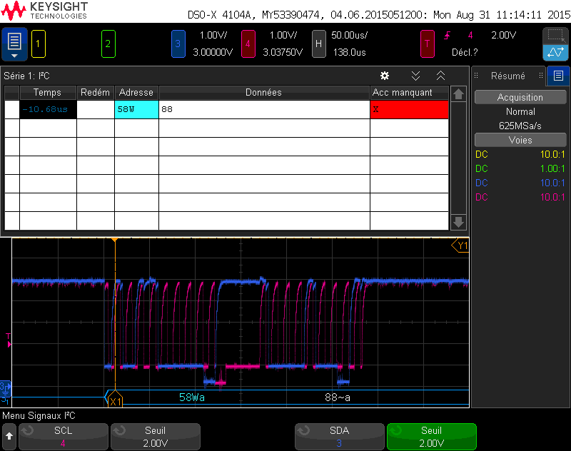

3 : I created a new bare metal project, with only functions for communicate with the PSU. The bus crash after less than one minute, I took a screenshot :
I hope you could help me to find the root cause.
