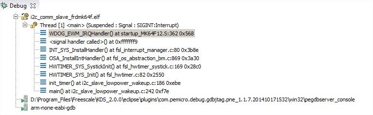

More information that may help. Here is debugger trace function:
The firmware gets stuck here:
DefaultISR:
    b DefaultISR
    .size DefaultISR, . - DefaultISR

Hi Vinicius,
I think the root cause of the exception is that the code wants Vector Table in RAM but it is in Flash.
As I stepped through your code it dies at following line in fsl_interrupt_manager.c INT_SYS_InstallHandler() function:
__VECTOR_RAM[irqNumber + 16] = (uint32_t)handler;//DES this code assumes vector table in RAM so if it is in flash an exception occurs when it tries to write to flash space.
Will look into this further but wanted to give you update.

It seems that the CPU called an interrupt, but the corresponding ISR is not set.
Verify that you have a function for every interrupt you have enabled.

viniciusmaciel
Hi Alice,
The example i2c_comm_slave_frdmk64 works, but if I add the code hwtimer_demo_frdmk64f inside it, it stops working. The reverse is also true,  hwtimer_demo_frdmk64f works without i2c_slave code.
(1) delete the ".matadate"  under workspace, then build , then test - Doing this still does not work.
(2) The last line executed: INT_SYS_InstallHandler() at fsl_interrupt_manager.c:80 0x3b82
/* Set handler into vector table */
As said giacomopetrini, it's an interrupt problem.
