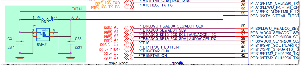

Robin_Shen
If you are using FRDM-K22F board, download the FRDM-K22F-SCH Schematics from this weblink.
You need check whether the crystal(Y1) and C31\C38 are  soldered correct.
That fei_blpi example works because it did't use the external crystal as clock source.
If the crystal is correct soldered, then other examples will works.

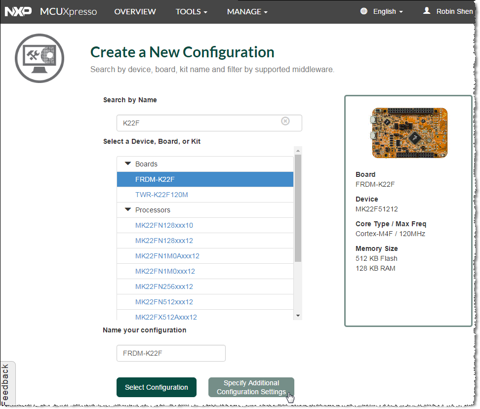

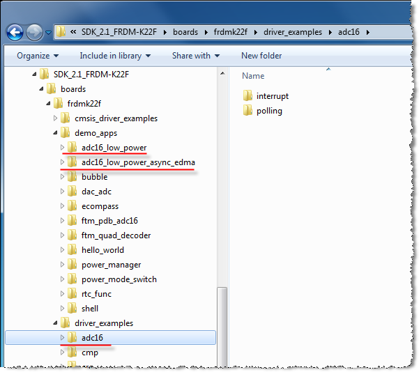

Robin_Shen

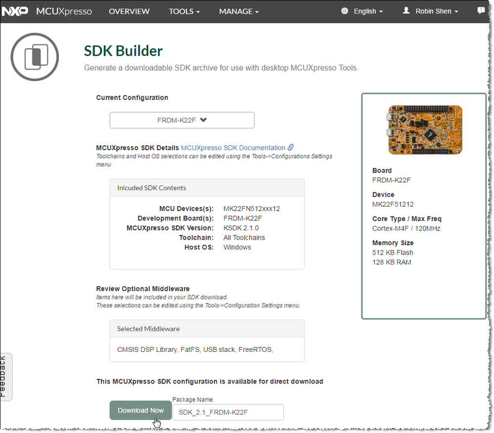

Since you are using FRDM-K22F board, why not direct test the ADC demo examples in SDK_2.1_FRDM-K22F?
Search 'K22F' then select FRDM-K22F board.
After specify additional configuration settings, you can download SDK_2.1_FRDM-K22F.
You can getting start with KSDK and KDS from reading below:
 "How to start with KSDK"  and "KDS Document List".
Robin

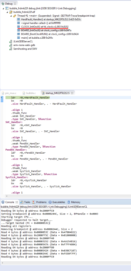

It looks like the examples in SDK_2.1_FRDM-K22F never works on your FRDM-K22F board.
From your first question "HardFault problem in KDS using K22F ", hardfault happens when trying to run CLOCK_InitOsc0() function. Have you ever modified the crystal circuit of FRDM-K22F board?

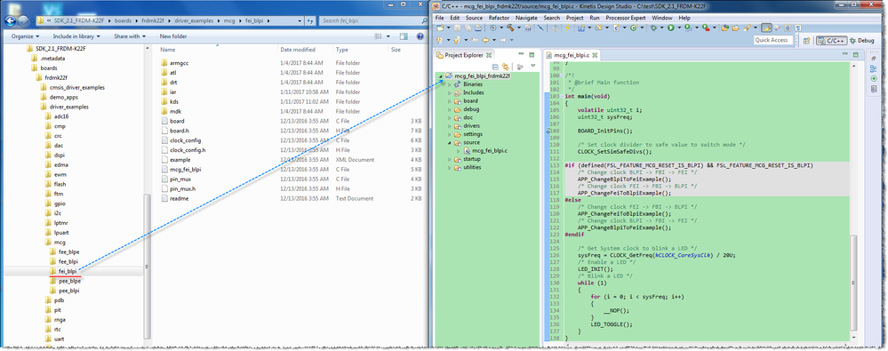

Would you please try to run the fei_blpi example( ...\SDK_2.1_FRDM-K22F\boards\frdmk22f\driver_examples\mcg\fei_blpi).
If that example works(the Green LED blink), you may need to check your crystal circuit.

jacewalton
the Green LED blinks. where do I find the crystal circuit and in what way do I modify it?

Robin_Shen
Robin

jacewalton
I got a different k22f board and the demo apps work, there must be a problem with my crystal circuit...
