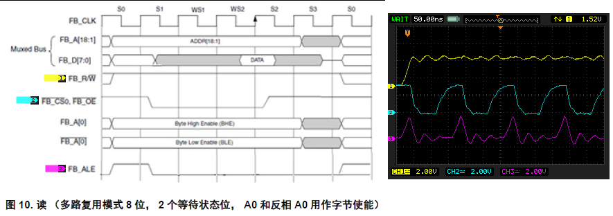

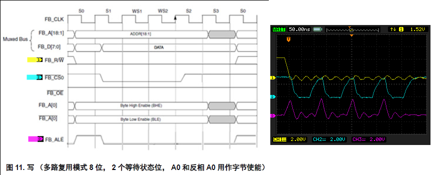

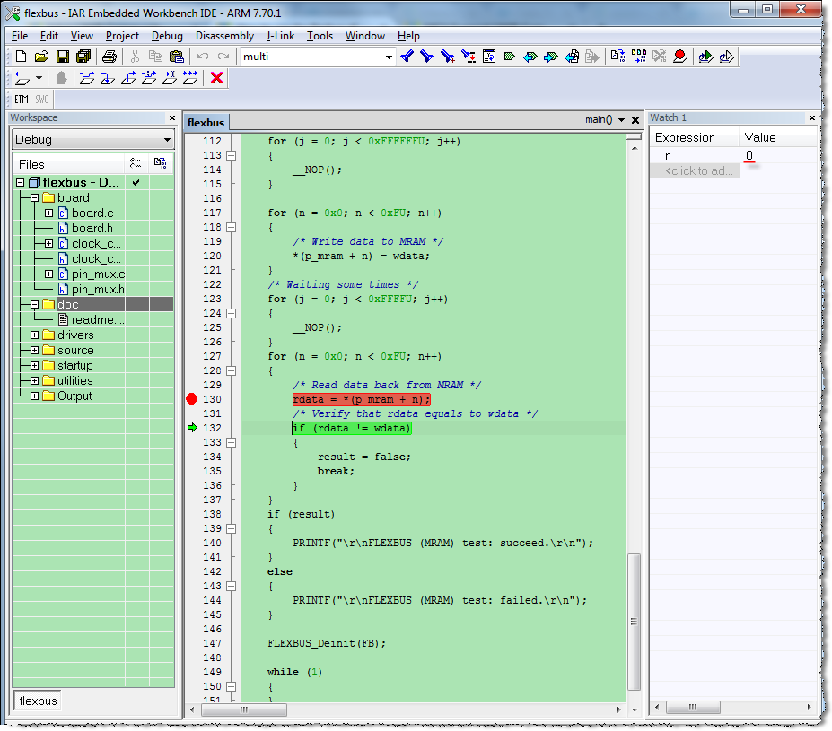

Hi zhai,
I test the flexbus example in SDK_2.1_TWR-K64F120M. The FB_ALE can be assert when measure it with osilloscope.
write:
read:

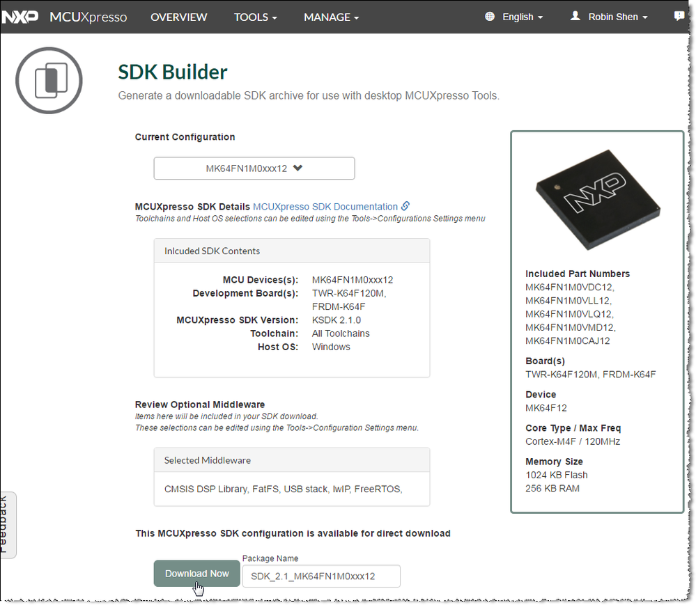

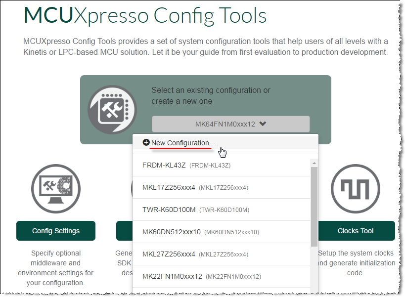

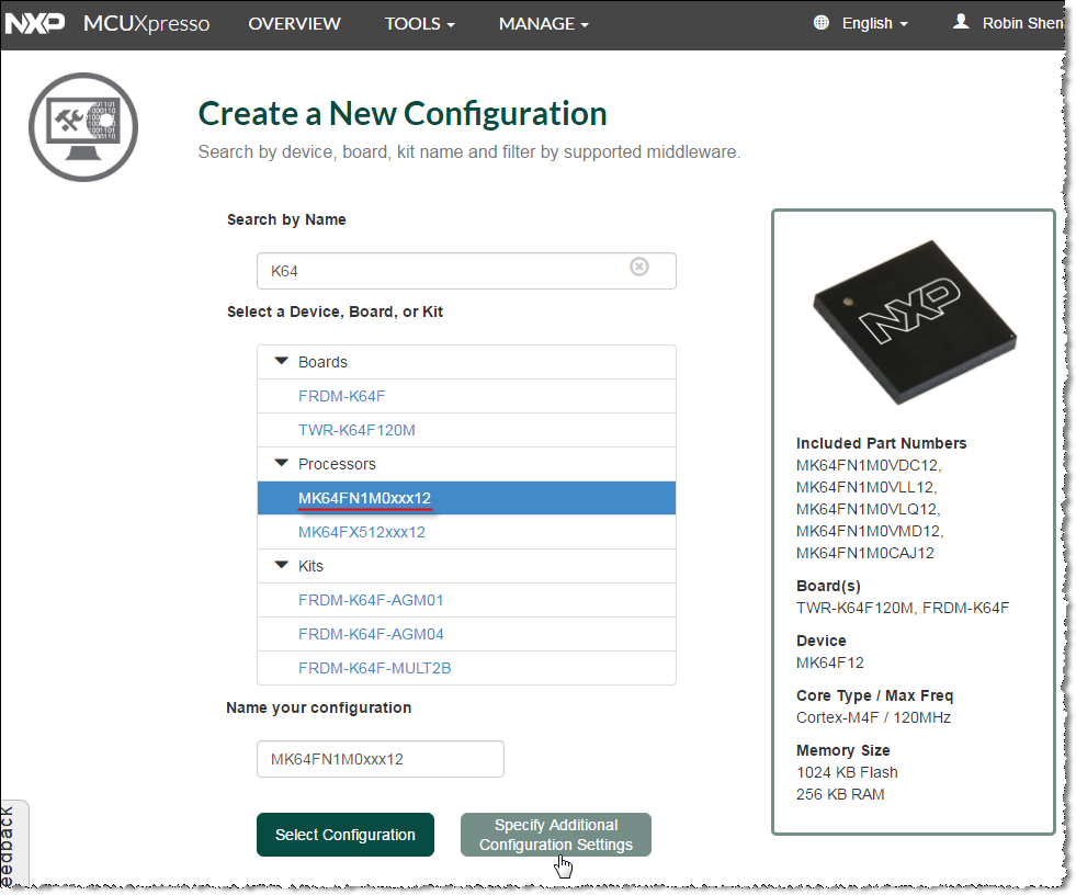

Robin_Shen
Hi Zhai,
You can download SDK_2.1_MK64FN1M0xxx12 from MCUXpresso Config Tools.
Robin
