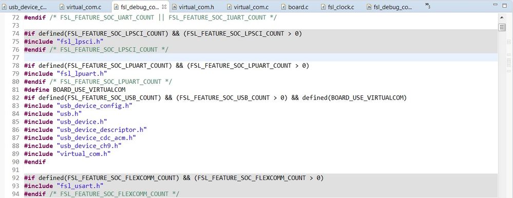

First, change the default debug console from UART to USB. In fsl_debug_console.c, open the definition and add some items:
Then modify DbgConsole_Init:
#if defined(FSL_FEATURE_SOC_USB_COUNT) && (FSL_FEATURE_SOC_USB_COUNT > 0) && defined(BOARD_USE_VIRTUALCOM)
        case DEBUG_CONSOLE_DEVICE_TYPE_USBCDC:
            s_debugConsole.base = s_cdcVcom_pt->deviceHandle;
            s_debugConsole.ops.tx_union.USB_PutChar = VirtualCom_SendDataBlocking;
            s_debugConsole.ops.rx_union.USB_GetChar = VirtualCom_ReceiveDataBlocking;
        break;
#endif /* FSL_FEATURE_SOC_USB_COUNT && BOARD_USE_VIRTUALCOM*/
Since in SDK2.2, s_cdcVcom is a static structure in virtual_com.c, I use a pointer s_cdcVcom_pt to quote it here.
