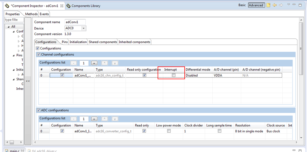

For some reason I have a new event, ADC0_IRQHandler. I don't want to convert on an interrupt, I want to:

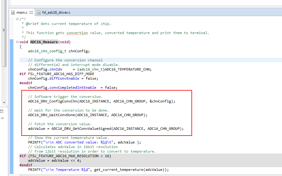

1. Start a conversion in code. (can't find anything that looks like it will do this)
2. Wait for the Conversion to finish, See this one: ADC16_DRV_WaitConvDone(adConv1_IDX,); But not sure what the pass values are..
3. Get the results, also see this, ADCBattvaule=ADC16_DRV_GetConvValueSigned(adConv1_IDX,); Again, not sure what to pass in..
What is the structure to get the adc started?
And, exactly what should I put after the comma in the in the parenthesis?

Hello Rande,
- I recommend you refer to one ADC demo , under the KSDK1.3  there is no ADC demo about MK02 chip,
while you can refer to the other chip demo, for example , you  can refer to the TWRK60d100m
(KSDK_1.3.0\examples\twrk60d100m\driver_examples\adc16), the usage of the functions is the same among the
chips, you can also refer to how to pass the parameter.
In the example , you can see the three functions you mentioned :
- About the interrupt of ADC complete , you can disable it at here(uncheck the "Interrupt")

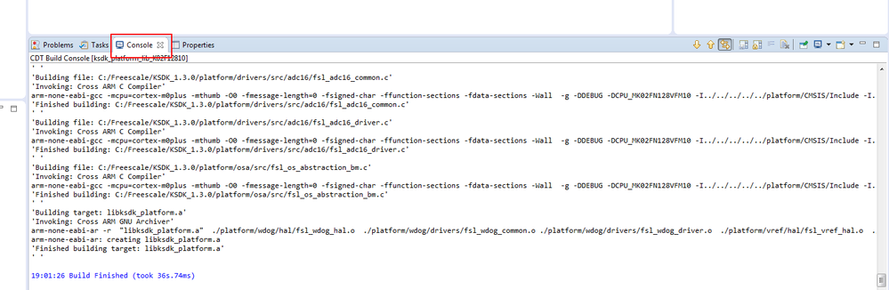

After I debugged the ADC without a problem, I found an error popped up
in the SDK>drivers>src.adc16 > fsl_adc16_driver.c. I tried close, exit ,
open, clean, rebuild but the error is still there, see below pic.
It does not affect anything so far..but do you know what would cause
this, or how to remove the error?

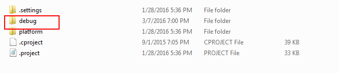

Please delete the ksdk_platform_lib on the KDS project explorer :
then delete the "debug" folder :
then re-import it , build.
If still have error , please show me the console window :
(Doesn't you change the code of the driver ?)
