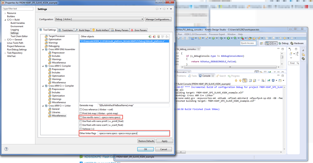

Hi Everyone,
I'm Trying to run Master_Slave project that is applied on FRDM-K64F board that can be found in this link
KSDK SPI Master-Slave with FRDM-K64F
but when I build the project like for Master or for Slave, I get one make file error :144928_144928.jpgerror_kds.jpg
I'm not sure what I am doing wrong! my steps are as follows:
  • importing the project into my workspace,
  • building the ksdk_platform_lib
  • then build the project
any idea how to solve this problem?

Hi Mona Khanafriboor,
Please, the project was developed in older version KDS. For this case is needed to do this change with the linker:
Please fill -specs=nano.specs -specs=nosys.specs and uncheck the option "Use newlib-nano (--specs=nano.specs)"
I tested on my side and now it works without problems.
Please, let me know, if it helps you.

monakhanafriboo
thank you for your reply,
Actually you are right I did the same thing and its working perfectly now.
